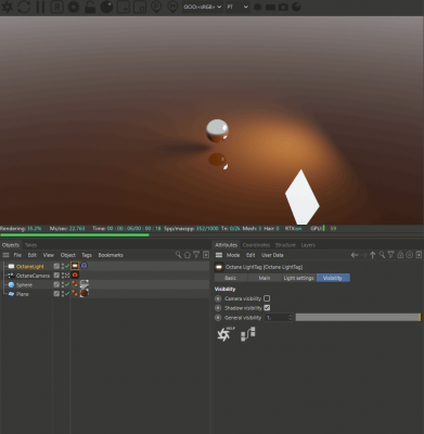

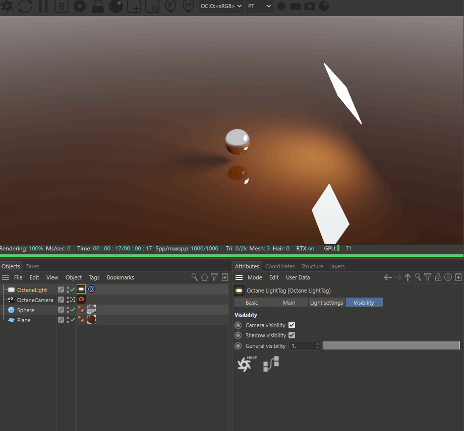

I understand the concept and of course it works like you described there is no doubt on that.
I am trying to avoid having the "square" reflection of light showing on the other objects. For eg on the sphere and on plane in this instance..
Is something like this possible?

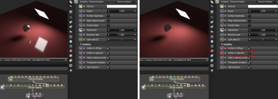

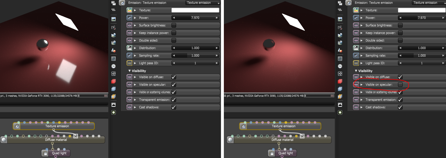

I don't use c4d, but one way to do this is to disable "visible to specular" on the texture emission node.
You'll need to find where that's done in c4d.

funk wrote:I don't use c4d, but one way to do this is to disable "visible to specular" on the texture emission node.
It's in light tags
