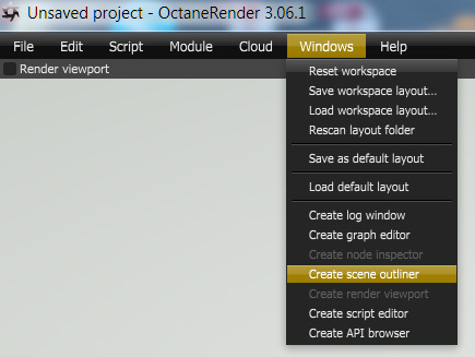

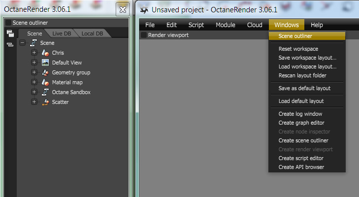

Scene Outliner [see pictures : have to create it first]

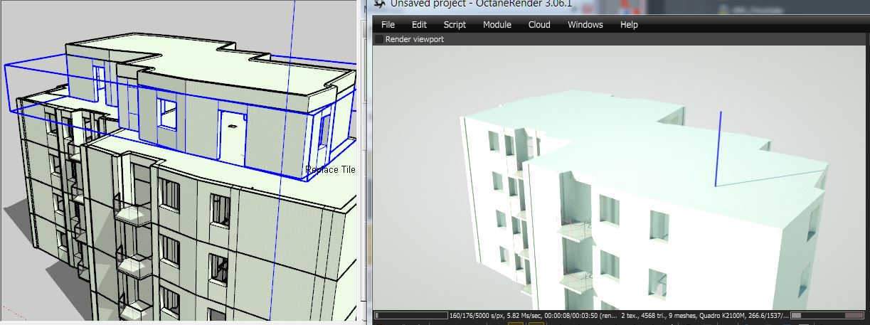

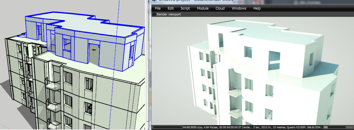

Another bug here.
Engine doesn't render some groups / components
(see Pictures)
Solved exploding them.

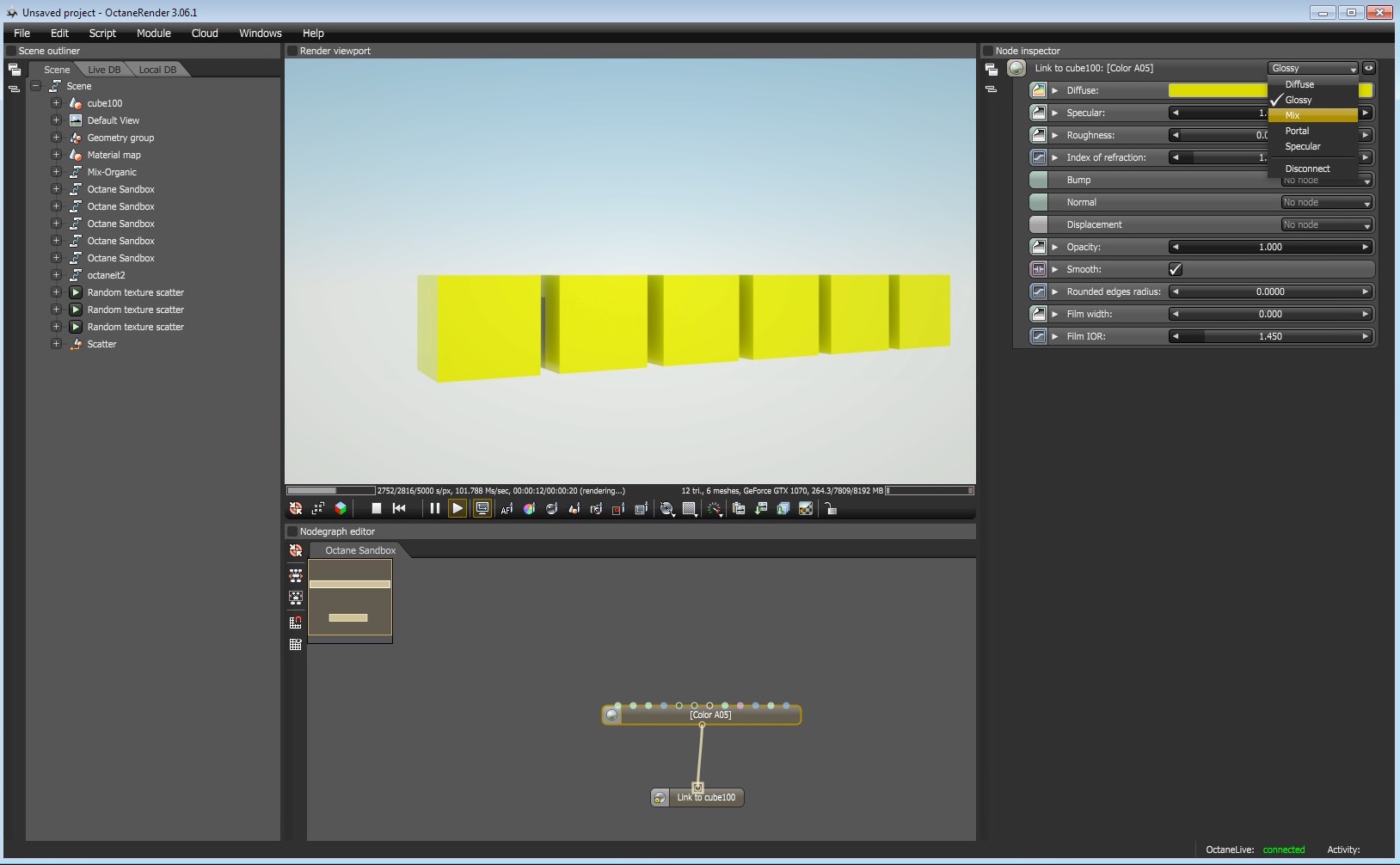

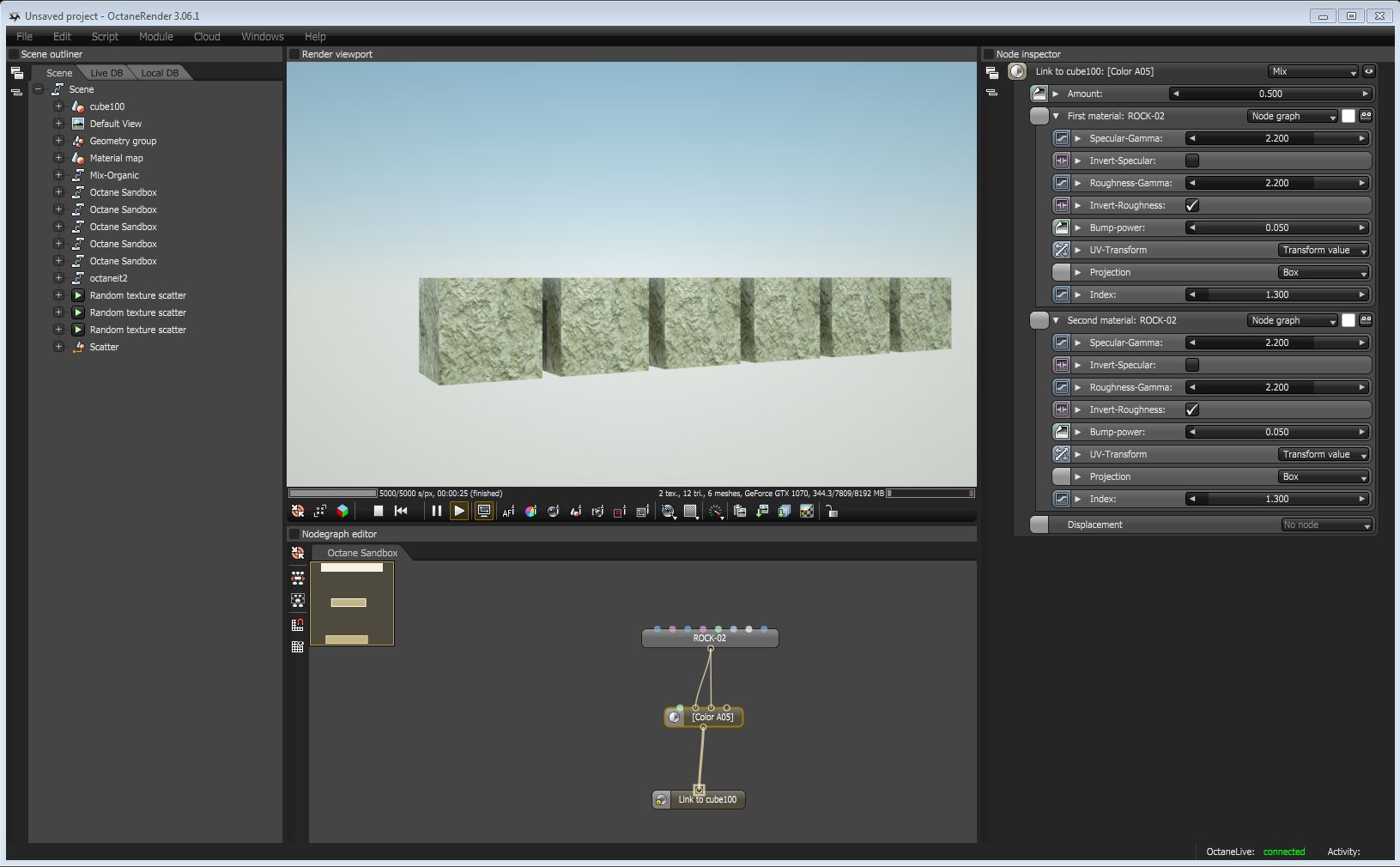

Now finally we have local DB, but all assigned materials inside Octane Engine are lost closing render window or pressing stop button ... each time. DOH!
oops sorry, I forgot to mention that this happens because the plugin is losing the connection with the SU material. To workaround the issue, please transform any default Glossy material into a Mix Material:
Then copy/paste, or create your own material, and connect it to both the materials pins of the mix material:
Finally save the SU scene, in this way the connection is not lost, and the material is correctly saved.
Happy rendering :)
