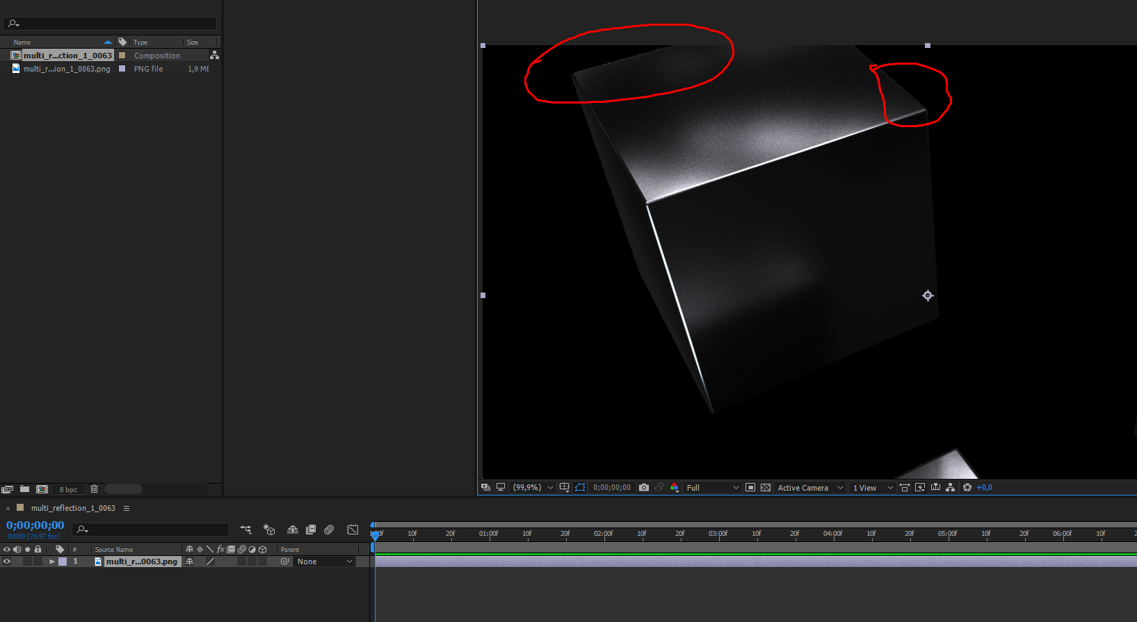

Awesome thanks a lot. This fixed the jaggy edges in the demo scene but i still get the jaggy in the multipass render of my new animation that I'm currently working on for a client do you know how to fix it ? i checked the camera tag settings and that fixed the demo scene problem from last time the only thing is in my multi passes of the animation, I currently work on have very jaggy edges that's the only thing i need to get fixed please btw should i stay at version 3.05.3 or should i better download an older version ? I'm new to the octane renderer and saw a lot of people still using octane v 3.02 I don't know if it's better to downgrade or stay at my current version ?

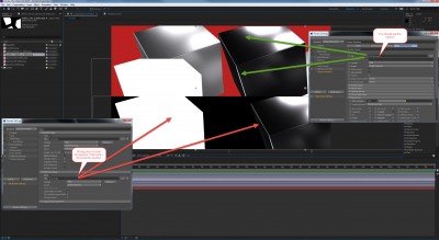

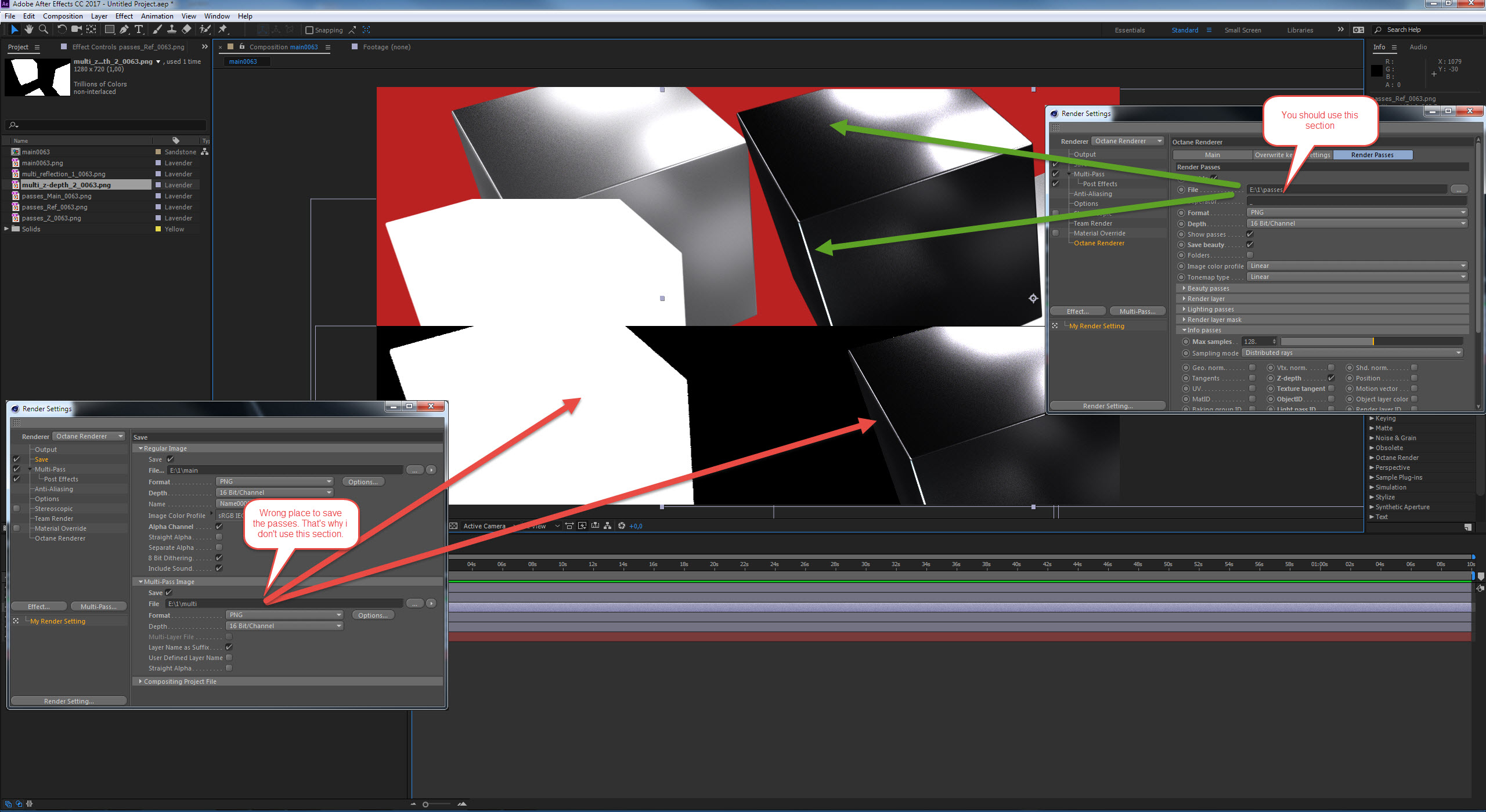

Please send me that small part of your objects with current settings. I don't believe there is any bug for that. Propably you're missing somethings for correct usage. You have to check results on compositing software not in Picture Viewer. Picture viewer is not capable to show the alpha applied results of octane.

ok thank you very much. I did now an example project very quickly because i can't share the clients project that I'm working on that's why i made a very simple project with cubes. When I render the scene i get the edges in my passes for example in my z-depth pass and reflection pass, i imported the footage inside after effects and I'm still seeing the jugy edges

Please check my this video
https://docs.otoy.com/#cinema-4d-v3-plu ... er-z-depth
Whole thing is not so hard. Only thing you need to don't change default settings and save as 16/32 bit linear exr/tiff/psd. Pass tonemap type=linear.
