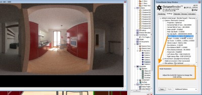

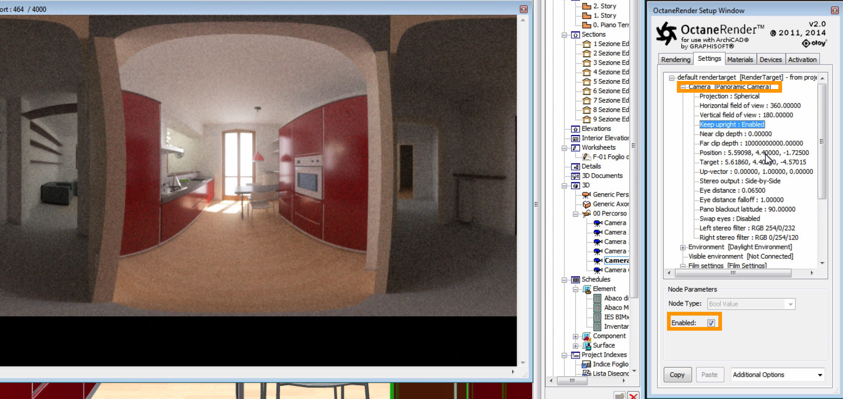

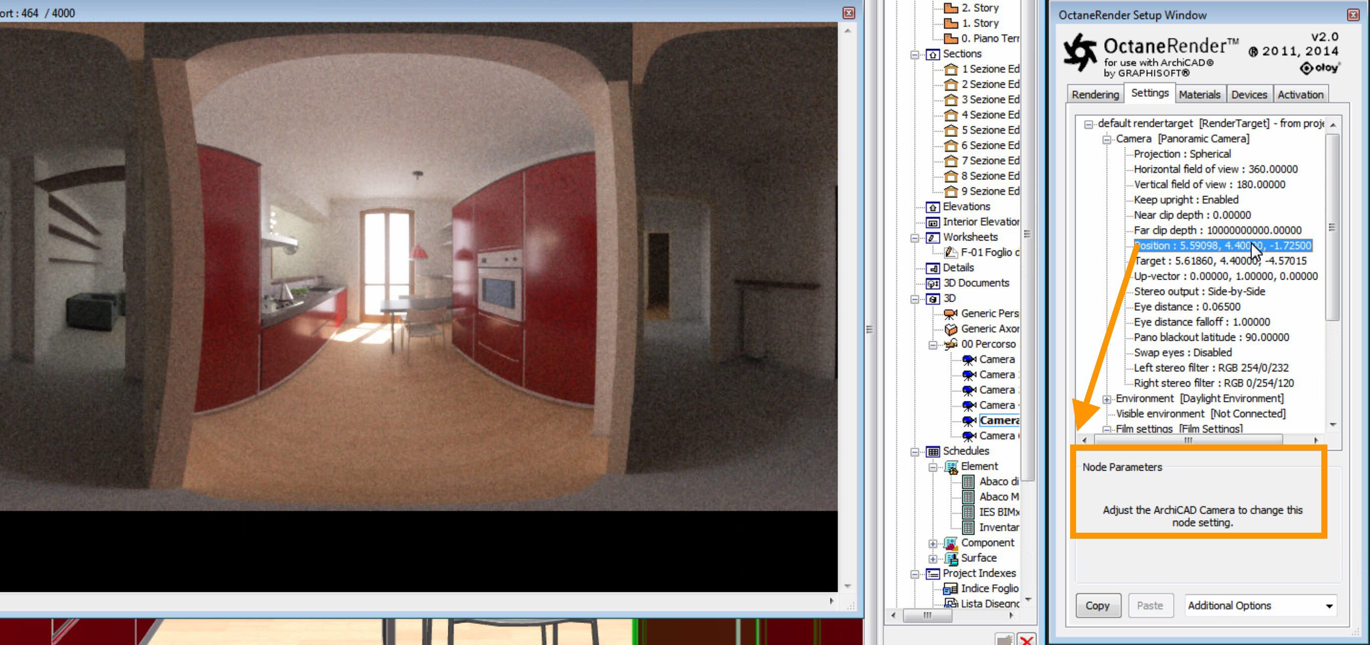

yes sure, you have to change the hight of the ArchiCAD camera to adjust the hight of the view, you can also enable the Keep upright option:

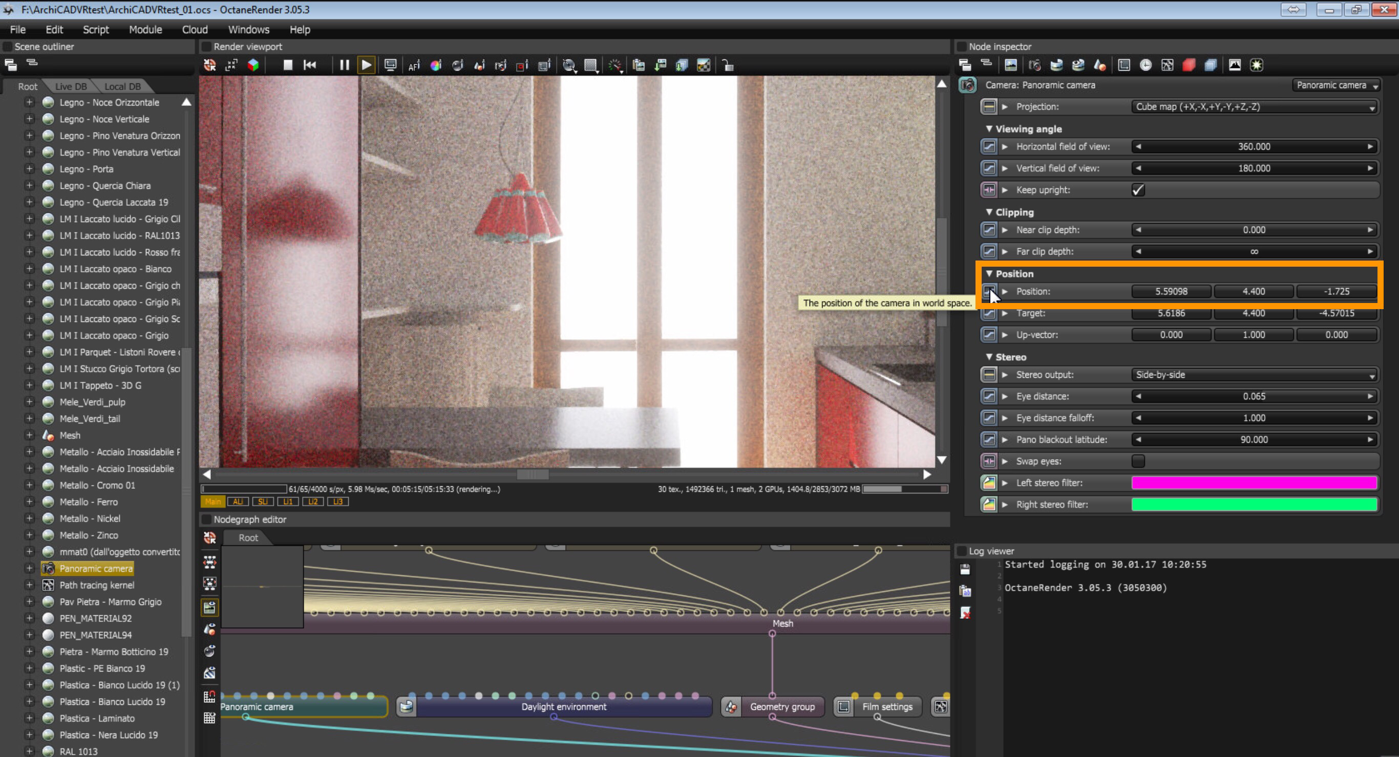

You can also change the position of the camera in Standalone, or duplicate it and change the position, in order to have different VR nodes:
