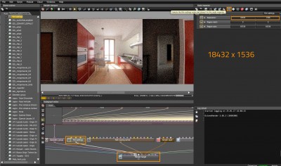

regarding VR and ArchiCAD, the 8k film resolution limit is an issue.
The workaround is to export the scene in .ocs or .orbx, open the file in Standalone click on the Render Target node to start rendering, and change the resolution value in the Film setting node to 18.432 x1.536: ciao beppe
