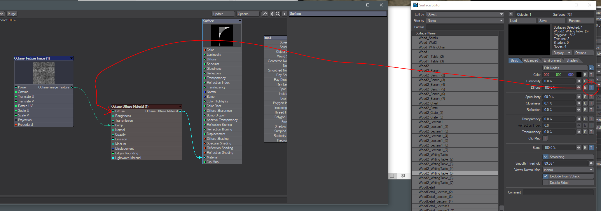

I would like this texture to be connected to diffuse input. I have this model exported from DAZ studio which has 100 surfaces like that when loaded into LW.

BorisGoreta wrote:I would like this texture to be connected to diffuse input. I have this model exported from DAZ studio which has 100 surfaces like that when loaded into LW.
And what happens in this case if there is also a color texture?
Thanks,
-Juanjo

Well I suppose then it works but I have a case where I have all textures in diffuse and none in color.
juanjgon
Posts: 8867
Location: Spain
BorisGoreta wrote:Well I suppose then it works but I have a case where I have all textures in diffuse and none in color.
The plugin can use the diffuse texture if nothing is available in the color. I suppose that this is not a problem.
Thanks,
-Juanjo
Well that's more an isolated/specific case then 'coz in LW since forever Color T cahnnel is where you put diffuse/albeido maps so i guess Juans' converter is correct in that regard.

Yes but I usually convert models from other software like DAZ3D or max converted files and sometimes LW loads those fbx or obj files with textures in diffuse not in color.
