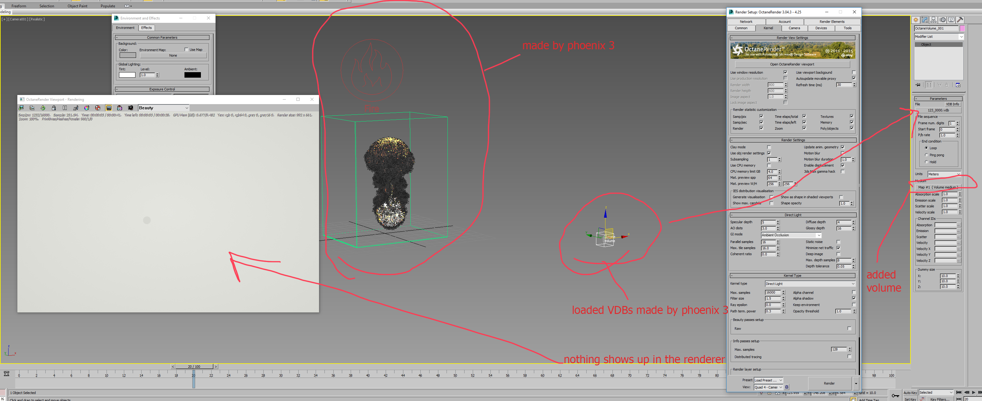

Hi. I exported fire and smoke as vdb. Then in phoenix 3 where it says input I chose that vdb sequence and octane is not showing it in renderer. is there any way to add octane volume to phoenix 3 or how do i render vdbs using phoenix 3 Thank you!

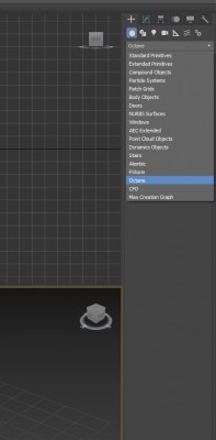

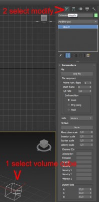

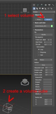

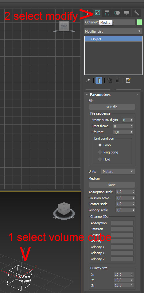

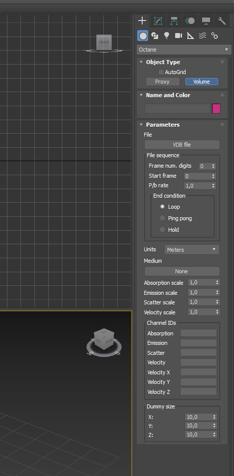

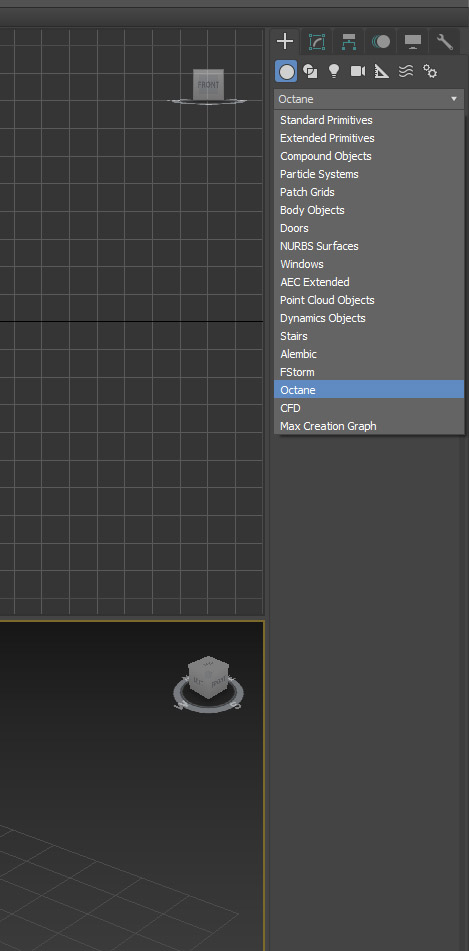

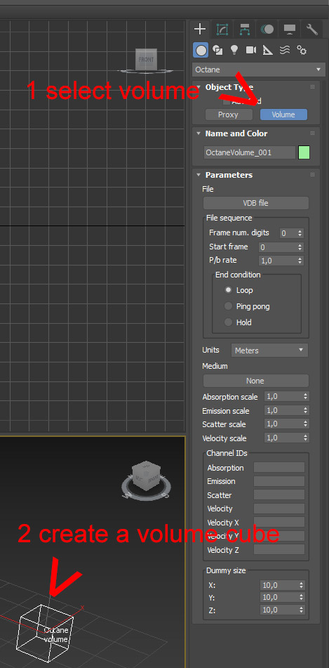

I ma sorry to bother you again. Do you know by chance how to add octane volume object in 3ds max?
Thank you
paride4331
Posts: 3995
Hi coilbook,
Regards
Paride

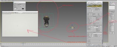

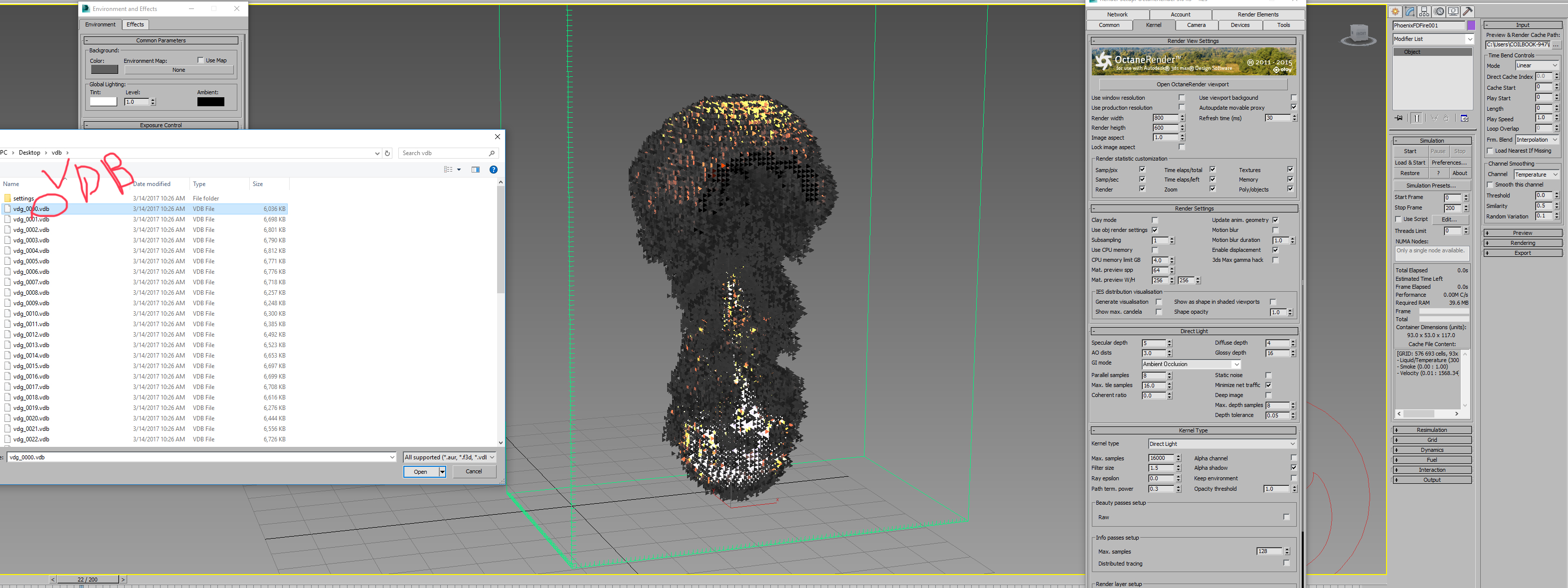

But i still cannot those VDBs that I created Phoenix 3 to show up in the renderer
I created VDBs with phoenix 3
loaded them into octane object
added medium
