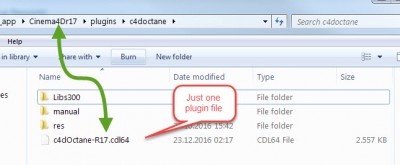

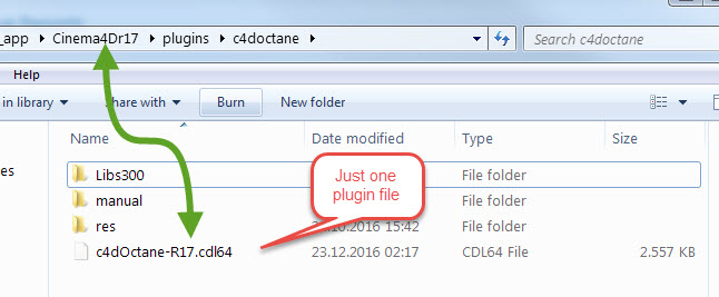

Yes I always delete unnecessary plugin versions when installing, I'm on R18 so deleted all the other versions.aoktar wrote:Well! I could watched your video. Again It's most likely not a plugin bug. Something should be wrong on your side. Maybe SLI enabled and bridge connected.
Why don't you open Octane log window after seeing errors? Keep it and Console windows open while working for any errors.
