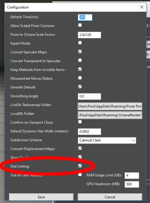

NOTE: You need to ENABLE Dial Linking in the plugin Configuration in order for the above to work
yes but HOW ?
yes but HOW ?
Click the Setup button, then tick the Dial Linking checkbox.

See attached.
