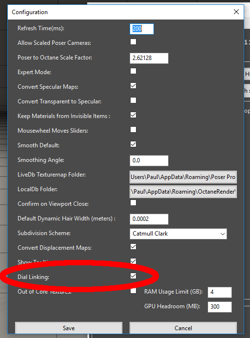

yes i have see, but is not see the dial option on material
NOTE: You need to ENABLE Dial Linking in the plugin Configuration in order for the above to work
yes but HOW ?

Click the Setup button, then tick the Dial Linking checkbox.

please can you send me a screenshot ?

See attached.

if i try to open setup i see this message
my version is V2.24.1.61 32bit
Traceback (most recent call last):
File "C:\Program Files\Smith Micro\Poser 11\Runtime\Python\addons\OctaneRender for Poser\SetupForm.py", line 515, in EventConfiguration
File "C:\Program Files\Smith Micro\Poser 11\Runtime\Python\addons\OctaneRender for Poser\Configuration.py", line 709, in __init__
WindowsError: exception: access violation writing 0x00000000
face_off
Posts: 15830
Location: Adelaide, Australia
The 32bit version of the plugin is no longer supported (and I no longer have a 32 bit system to test on anyway) - so I can't help with the crash - sorry. However you can manually enable dial linking by editing the config.xml file (https://docs.otoy.com/manuals/products/ ... /defaults/) and adding
Code: Select all
DialLinking="True"
Paul
