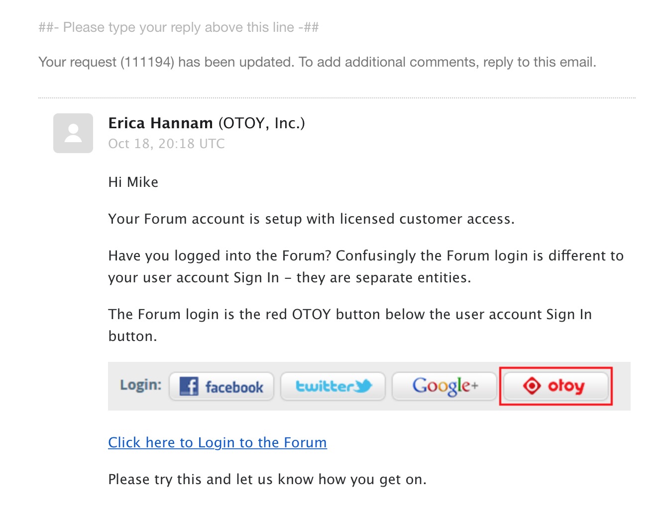

I know its strange. I think its because I don't have 'Licensed Customer' under my avatar even though I am, maybe people think I've got a cracked version or something. I have got in touch with Otoy support for a few issues and never once got one of them sorted, no offence to them. Maybe its because I signed up to the forum before purchasing Octane, not quite sure if I did.Edit: No one else - out of a thousand - seem to want to contribute. Weird.
