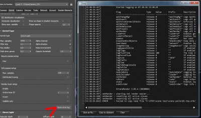

Hi coilbook,
Did you chek the "Minimize net traffic" option in setting Kernel?
Could you use the octane_log for more information on your issue?
To do this, you have to copy the file "octane_log_flags.txt" in 3dsmax main root
and "octane_daemon_log_flags.txt" into the Standalone directory on the slave computer.
remember to enable the permissions to write in 3dsmax folder etc..
e.g. select 3dsmax folder > Rightmouseclick > properties > security > ...
After placed the "octane_log_flags.txt" and "octane_daemon_log_flags.txt", restart and generate the issue.
Octane will create "octane_log.txt" files, with info about your issue.
Attach those file to better understand what happens.
Regard
Paride

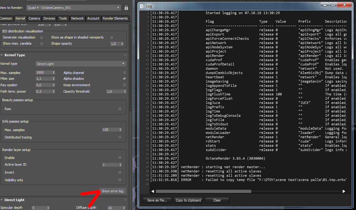

i attached the log. We have 7 itoo forests in the scene. Main one has trees and the other 6 have grass, braches etc. When we hide 6 secondary forests it renders fine, when we hide main forest and render 6 secondary forests (grass, twigs etc) it renders fine. But when we have all 7 forests in the scene it does this cuda error even though we have plenty of gpu memory
- Attachments
- octane 3.03.4 161007 091234.log
- (67.37 KiB) Downloaded 280 times

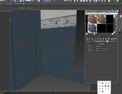

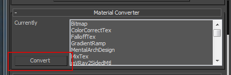

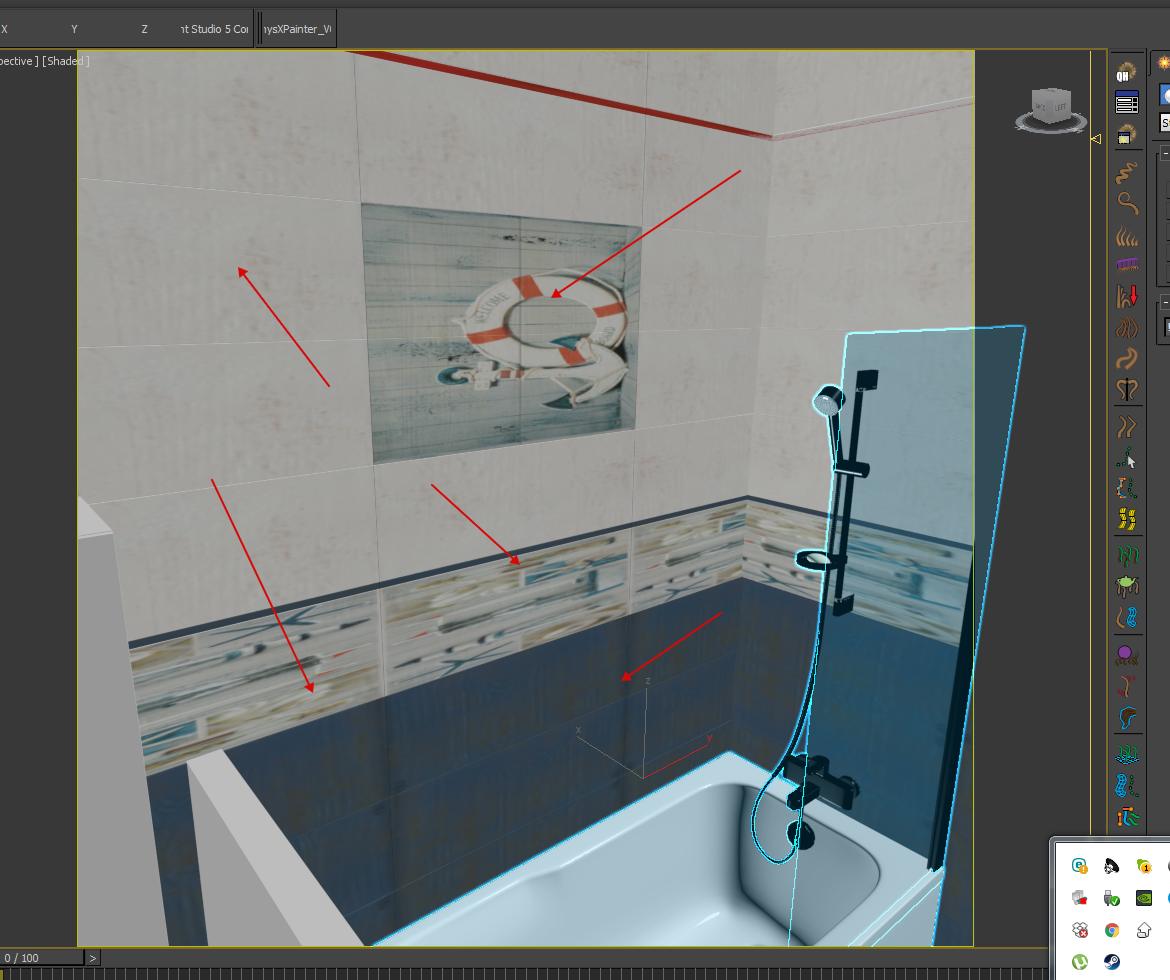

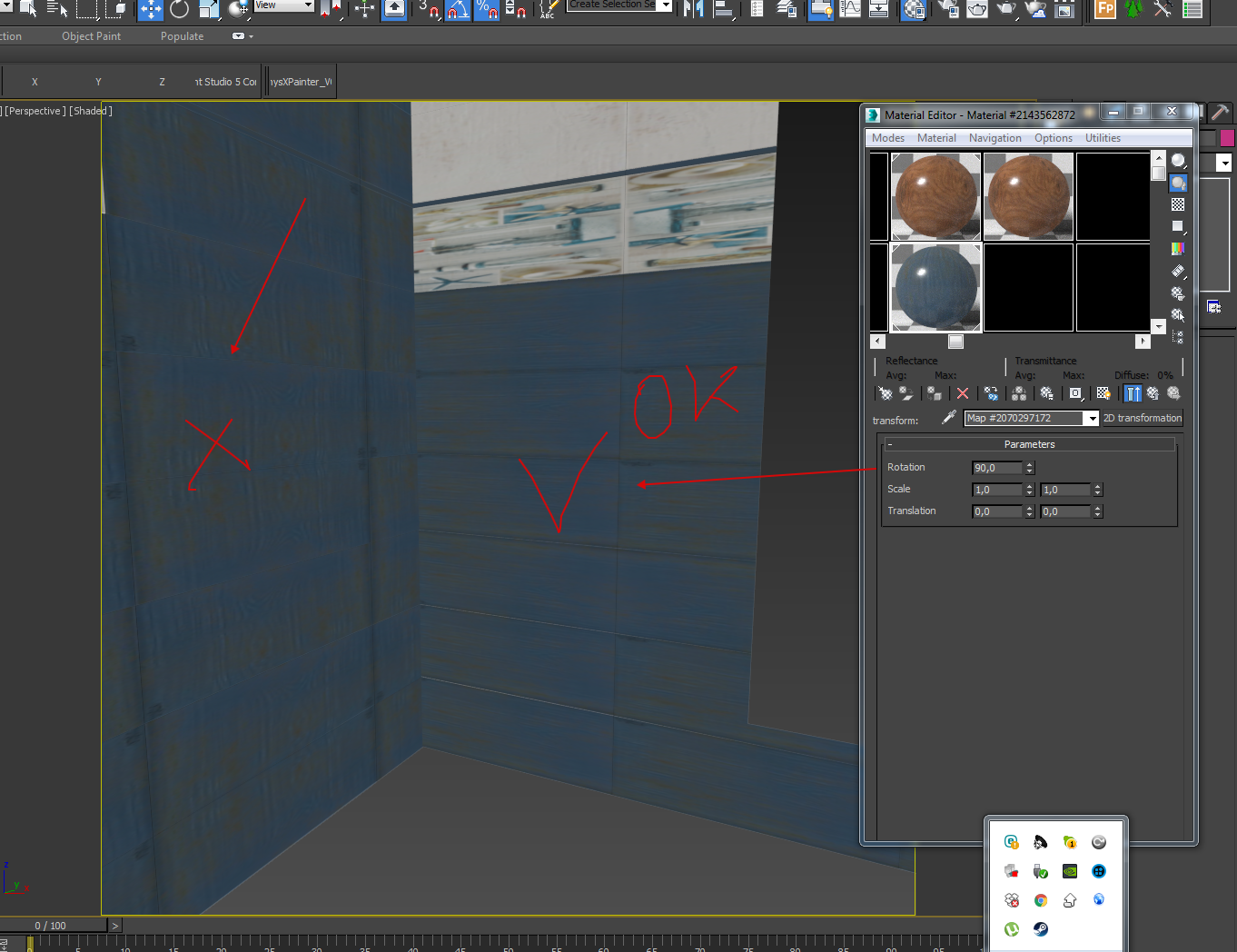

Converter converts wrong texture coordinates
Vray to Octane
Vray to Octane
- Attachments
- vray to octane.rar
- (567.07 KiB) Downloaded 304 times
- Clip2net_161009010301.png (9.59 KiB) Viewed 5346 times

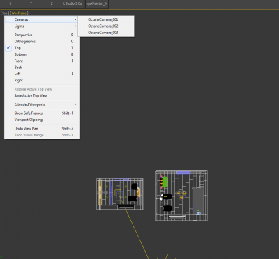

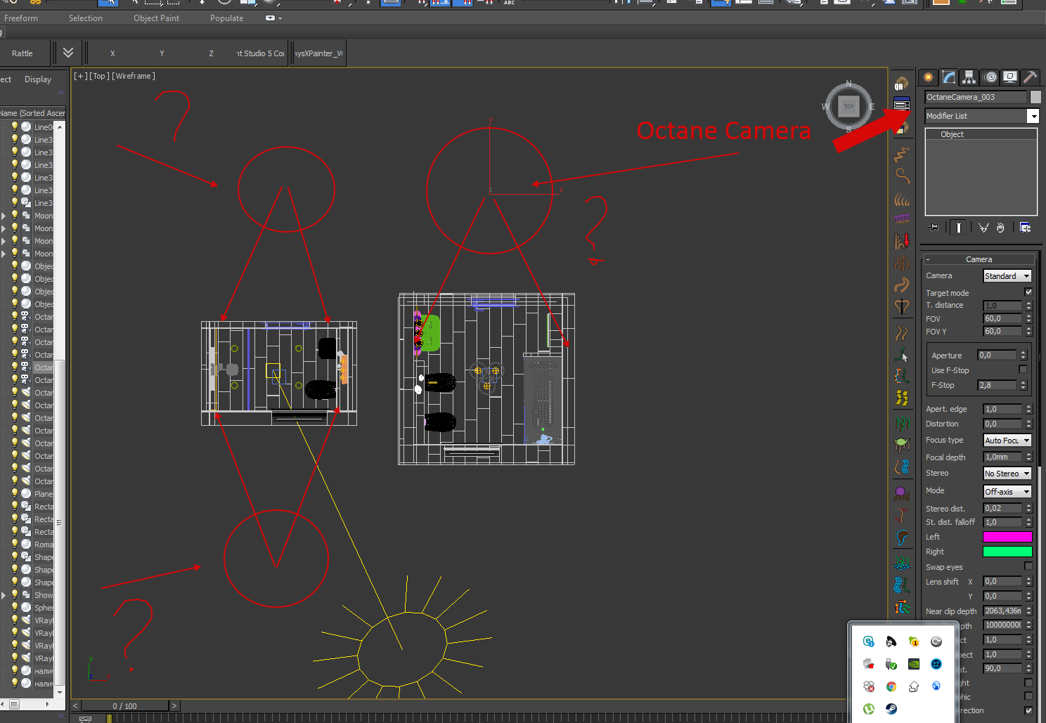

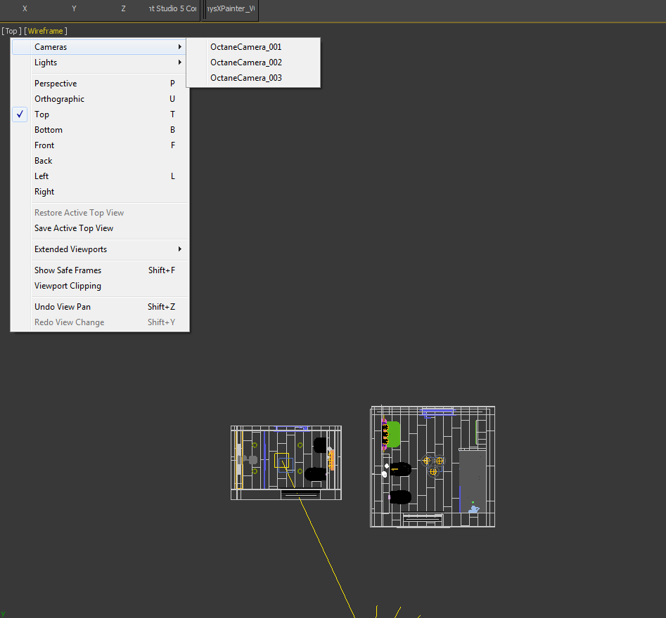

camera disappear
- Attachments
- bug camera.rar
- (18.26 MiB) Downloaded 271 times
- paride4331
- Posts: 4001
Hi Elvissuperstar007,
I verified and reproduced the issue you had.
I will send a file with the issue to developers Octane 3ds max plugin.
Thanks for your contribution.
Regards
Paride
Regards
Paride

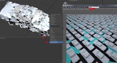

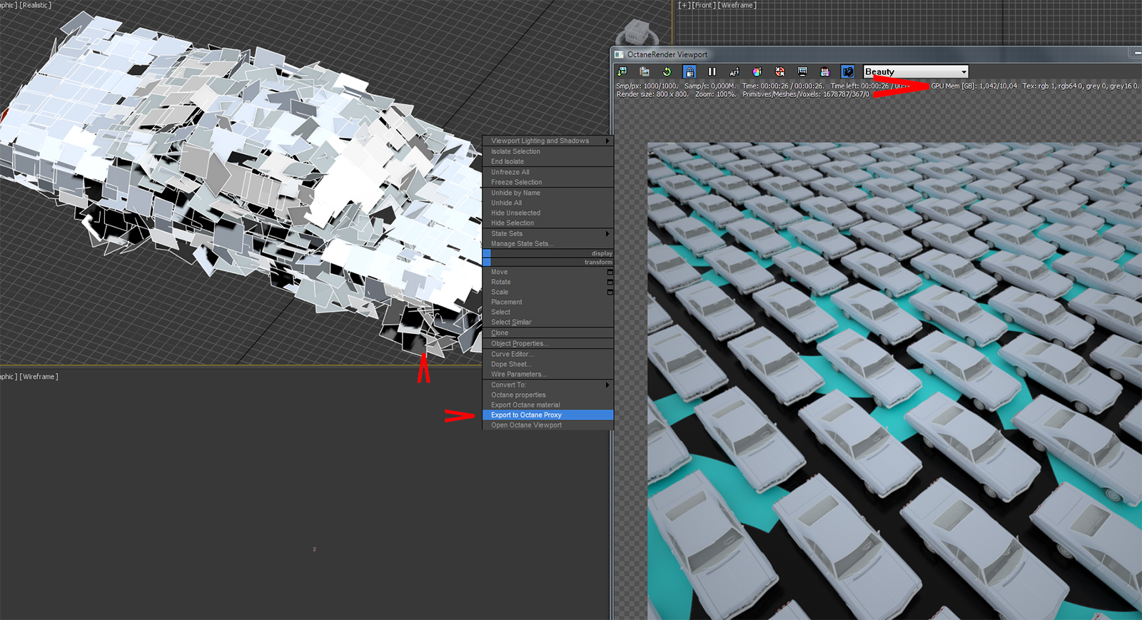

I got a lot of crash when I was saving render from render viewport. Also When I export the scene I got crash and v3.03.4 - 4.20 saved orbx file almost 4gb instead of 600mb. ( I reload 3.02-3.17 and could export the scene ) I think Octane couldn't export octane proxy objects. I am using Win 10, 3d Max 2017.
Chears
Chears
- paride4331
- Posts: 4001

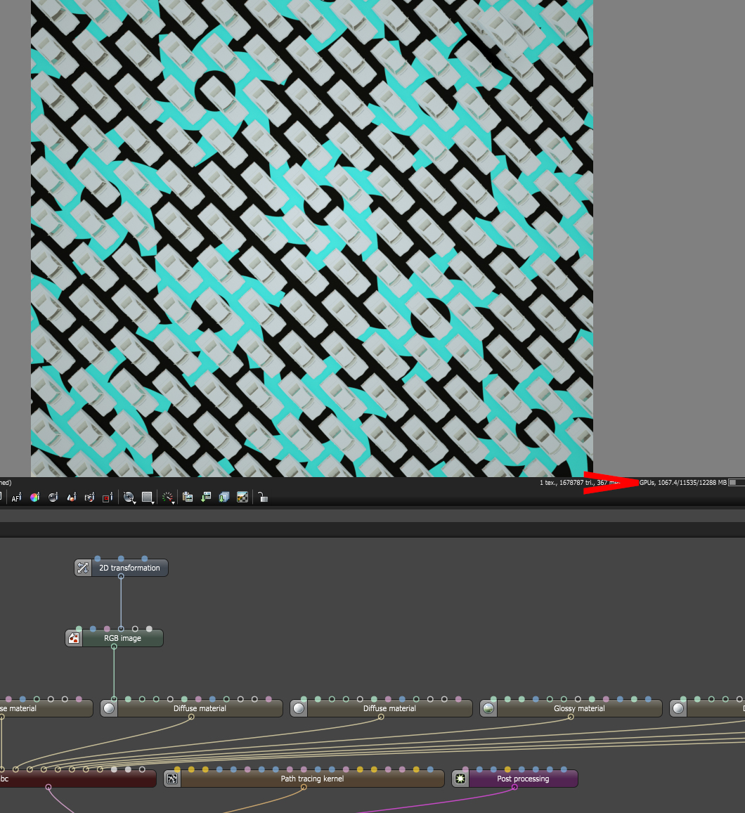

Hi Buraq,
Encountered cases of issue about save and crash.
The issue has already been sent to Octane 3dsMax plugin developers.
Octane 3dsMax plugin had his proxy system;
Best results, you could use the octane proxy system,
as in other render engine, before you use a scattering system.
As you can see in the screenshots, the occupied memory in 3ds max and stanalone coincide.
I hope to help you
Thanks for the support.
regards
Paride
I hope to help you
regards
Paride
