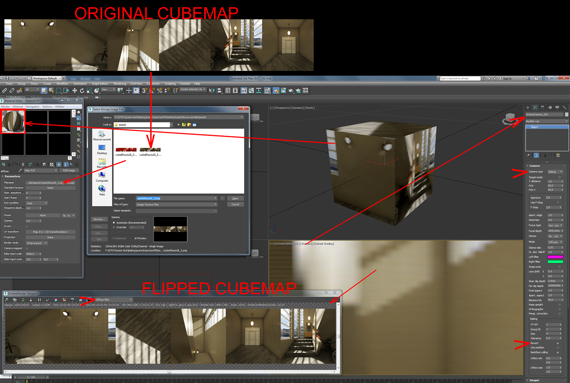

Thanks for the time Paride4331 ~ I think from this example you have shown me, you may have thought I was trying to reverse a Cube Map ~ but that's not what I am trying to do.paride4331 wrote:@solomonfl
Hi solomon,
I attached a screenshot about the cubemap baking workflow
Regards
Paride
I am starting with a full Scene with animated characters and other assets, not a cubemap ~ a full set ~ and I am trying to render just one Panel at a time, of my entire scene, to plug into the Unity Skybox (6 Sided)
And what I am asking the Otoy team is to offer an option that when I select for example +Z or -Z in the Octane Camera ~ that the result render does not get mirrored ~ and if another user needs mirrored, that an option is provided as say a check box
