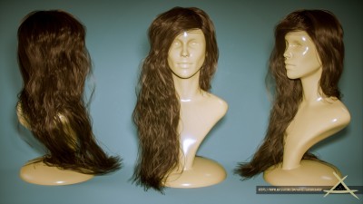

@ Rikk
Amazing work indeed!
@ ears of the scanned models
Are we seeing transmission effects for thin walled geometry,
is refraction and subsurface scattering going on in a volume
or had the scanned models actually just red ears by default which are now on the diffuse map?
-> Is the bust open at the bottom or is there some invisible wall to create a volume to allow SSS and refraction effects?
@ Elvis
Thank you for sharing as well!
@ Elvis

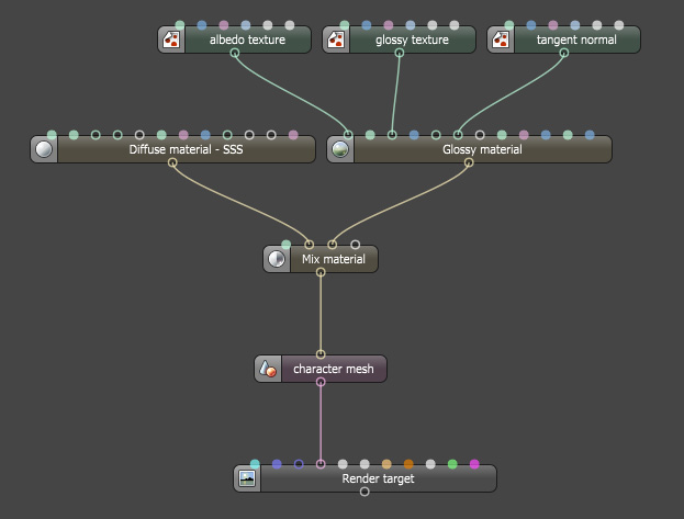

Yes, the ears get red because of the scattering.linvanchene wrote:@ Rikk
My skin shader is like this: Super simple stuff.

Thank you so much for posting the node layout.Rikk The Gaijin wrote: Yes, the ears get red because of the scattering.
I experimented with simple Mix Material Glossy and Specular before.
Then I run into the issue that with 0.5 to .05 material weight the scattering of the specular material makes the details from the diffuse (albedo) texture in the glossy material appear less sharp. In general simple mix materials with a specular part seemed to make the whole skin tone darker.
I will have to experiment with Mix material Glossy and Diffuse (SSS) again. Before I had no luck figuring out how to make the scattering part work with the diffuse material...

You might want to add a color correction node to your albedo texture.linvanchene wrote:Thank you so much for posting the node layout.Rikk The Gaijin wrote: Yes, the ears get red because of the scattering.

Diffuse/Glossy mix.Sorel wrote:I just want to be sure...this is a specular/glossy mix?

Thank you for share skin shader settings =) Really they are very simple =) Because I tried other hard way =))Rikk The Gaijin wrote:Diffuse/Glossy mix.Sorel wrote:I just want to be sure...this is a specular/glossy mix?
Love your work, man! It is Awesome! Every work
Best regards, Andrew.
