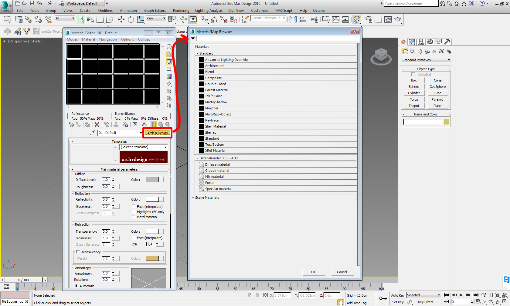

This issue is diferent kind.
Let me describe it:
When I'm in Material Editor and click Texture slot to choose Map type:
Or in Material Editor want to select Material type:
3ds Max hanging up to 20-25 (!!!!) minutes or more.
Depending how many materials/maps are in scene.
Sometimes I have to force shut down 3ds Max and loose all my work.
Please fix this!

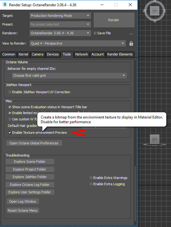

Hi haffy,
It could depend on about Textures and/or very heavy HDRIs in the material editor at the same time and/or shared on the network.
Does this issue also happen with local textures or hdri on the scene?
Did you try to "Enable Texture environment Preview" option?
Regards
Paride
