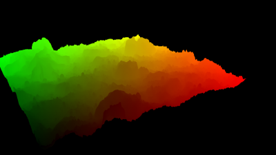

I am attaching an image. Only the ground had displacement but the entire image hade black jitter pixels in the info passes.
It took me a while to figure out why they suddenly appeared but I come to realise that it was after I introduced displacements.

I can't see black dots but white firefly? Do you mean these?

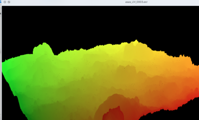

weird, this is what I get from your file at 16 samples: could you try to change the ray epsilon value in the kernel settings?

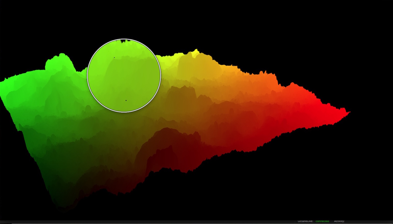

sorry, looking more carefully at my results with your scene, actually I can see the black dots by magnifying it: The same things happen also in Standalone, so is not plugin related.
