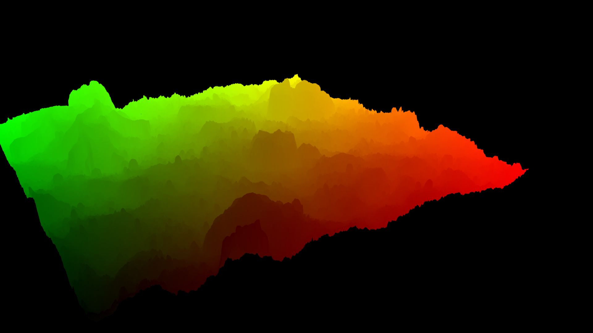

I can upload a scene tomorrow but the result is the same as the dropbox link I provided. Only in that there is only a displaced plane.
I am attaching an image. Only the ground had displacement but the entire image hade black jitter pixels in the info passes.
It took me a while to figure out why they suddenly appeared but I come to realise that it was after I introduced displacements.

This the final comp, I have painted them out. My point was that a small part of the image had displacements yet the black jitter pixel appeared in the whole of the depth pass (which has been fixed in the image). Dealing with animation is a different story as the black pixel appear randomly from frame to frame.

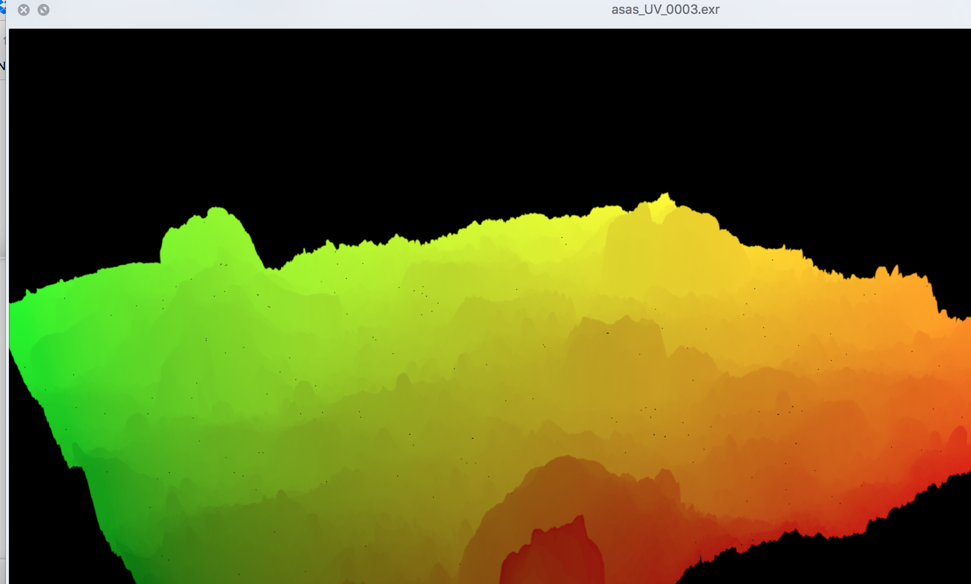

The artefacts look like this. (attached image). I have tried to raise the settings for max samples, Z depth max and UV max but it does not help. That seems to be the most logical solution but the black dots are still there.

Been testing some more, seems like I only get the artefact on singel sided polygons. So a plane plane produces bad results but a sphere does not. Don't know if that helps though.

sorry, looking more carefully at my results with your scene, actually I can see the black dots by magnifying it:
The same things happen also in Standalone, so is not plugin related.
I'm going to send an orbx to the devs to inform them about the issue, thanks for your patience.
ciao beppe
