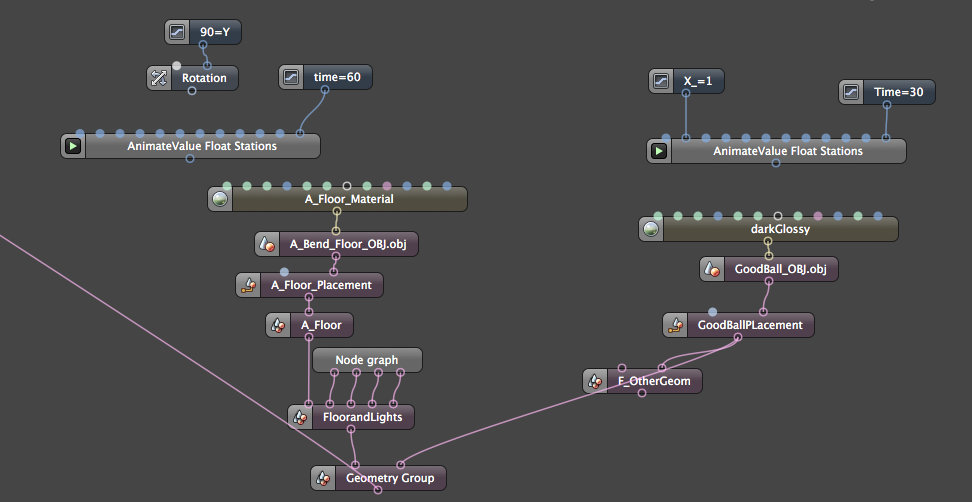

OK I'm still stuck
I loaded the script and see that I can put in different float stations and values by adding float values to the stations and add a time value for how long a transforamtion lasts... but what do I hook the script into?
If I want to rotate my floor 90 around Y and move a ball in x 1 unit
What goes into the script... a float value right? But how do you tell it to be a a rotational change vs a translational change etc?
And then how do you plug it into your object?
p3taoctane
Posts: 1418
Joined: Mon Jan 25, 2010 12:53 am
There is only an OUT node in the script what can it go into ??

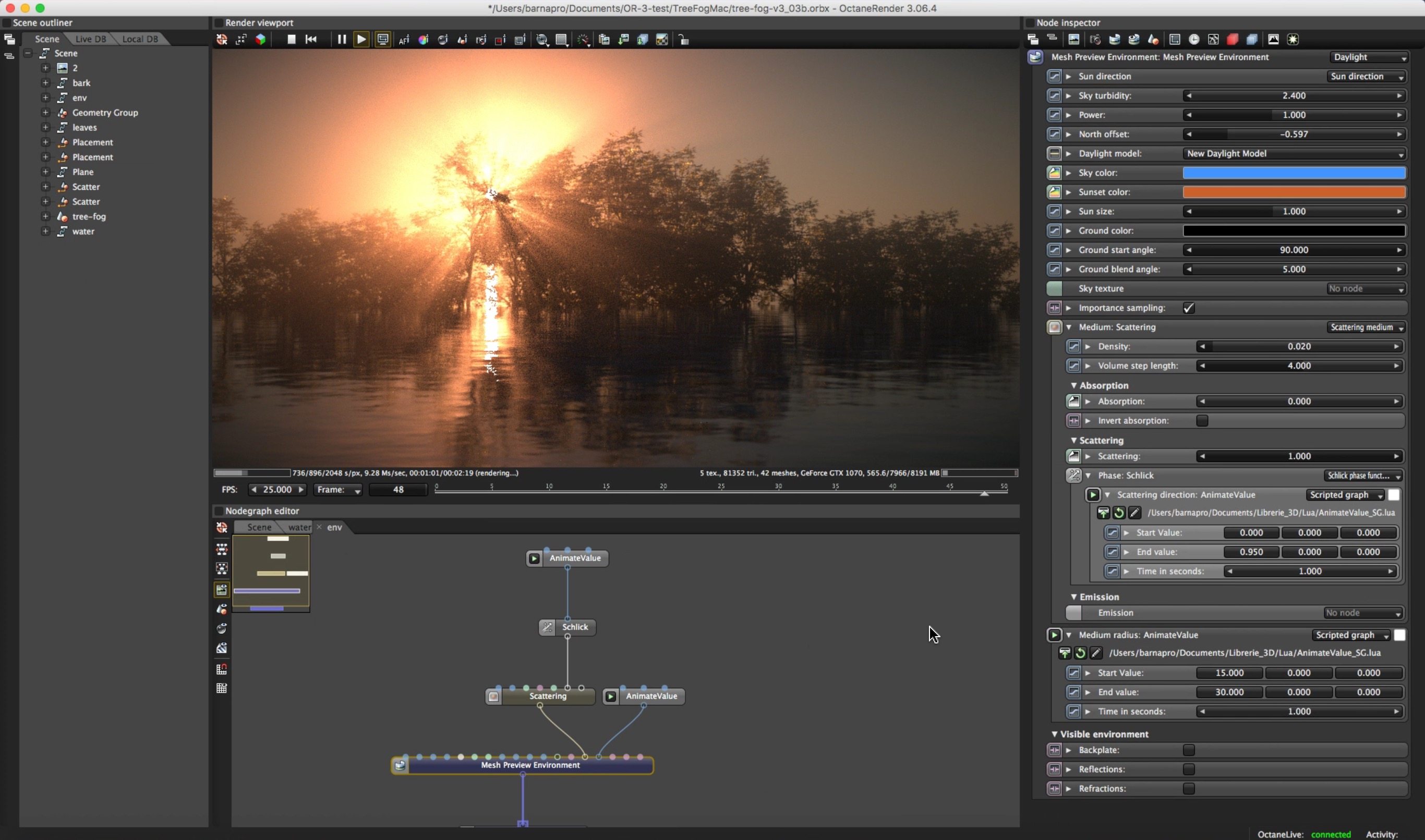

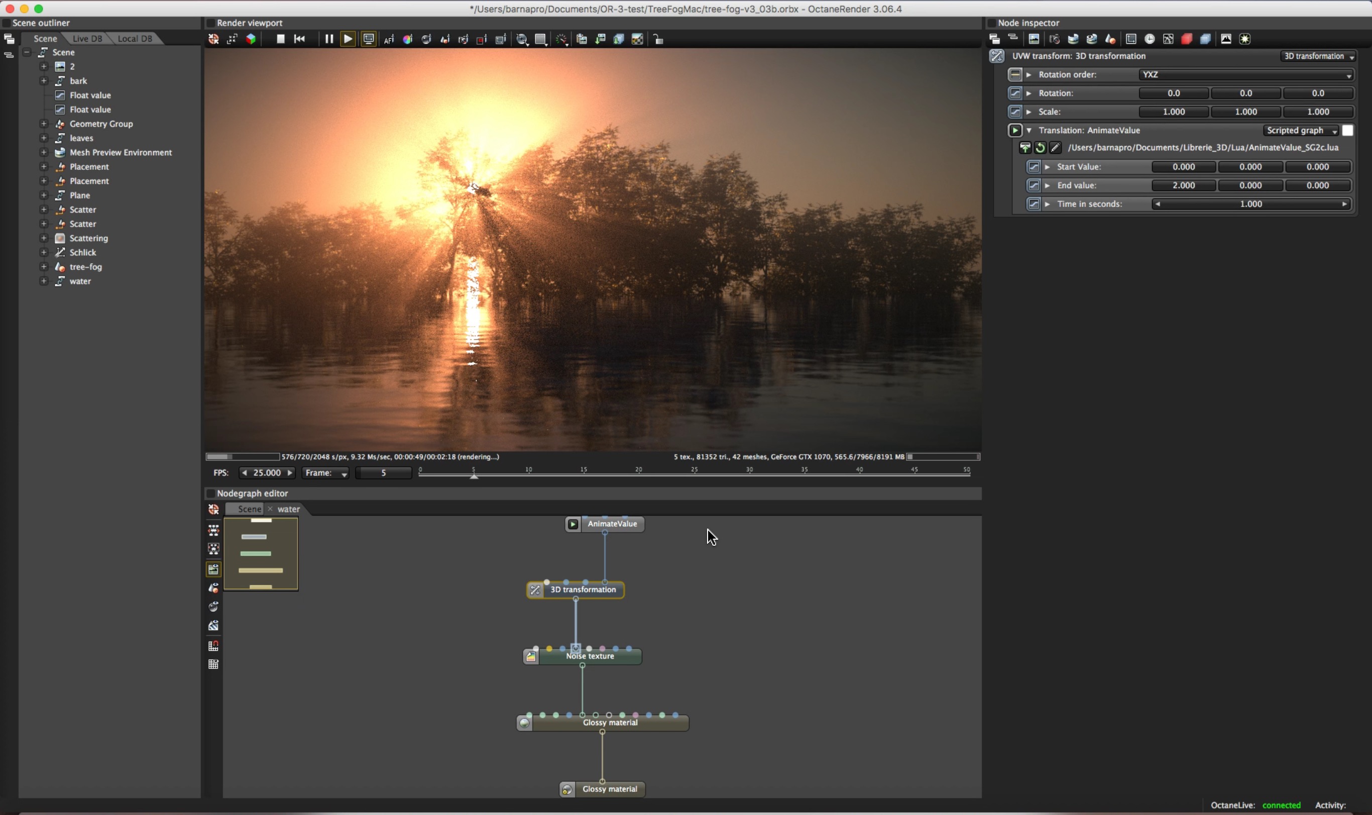

you need to expose the node with float values that you want to animate.
Please, have a look at this examples:
1. scattering Phase value and Medium Radius animated in the Environment node:
2. X transform value animated in a noise shader:
ciao beppe

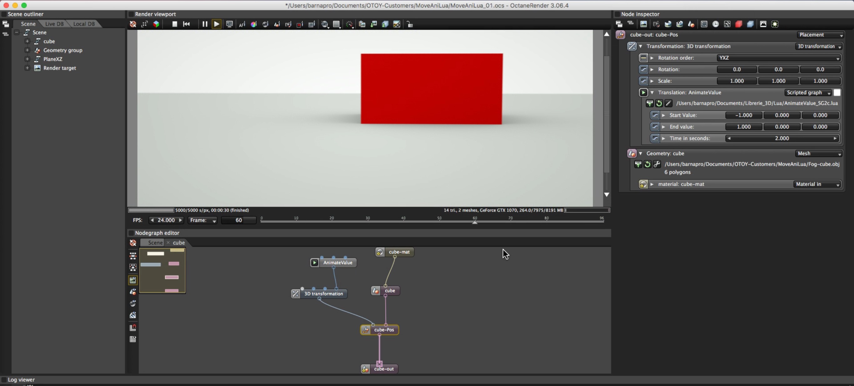

Posts: 10643
Hi Peter,
yes sure, you just need to expose the Transformation node of the Placement node:
in this example the cube is moving from x=-1, to x=1.
ciao beppe
