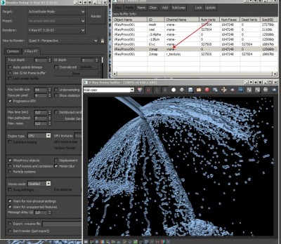

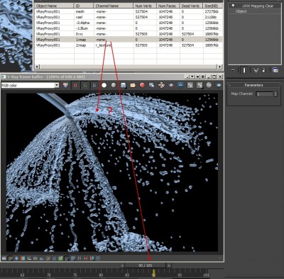

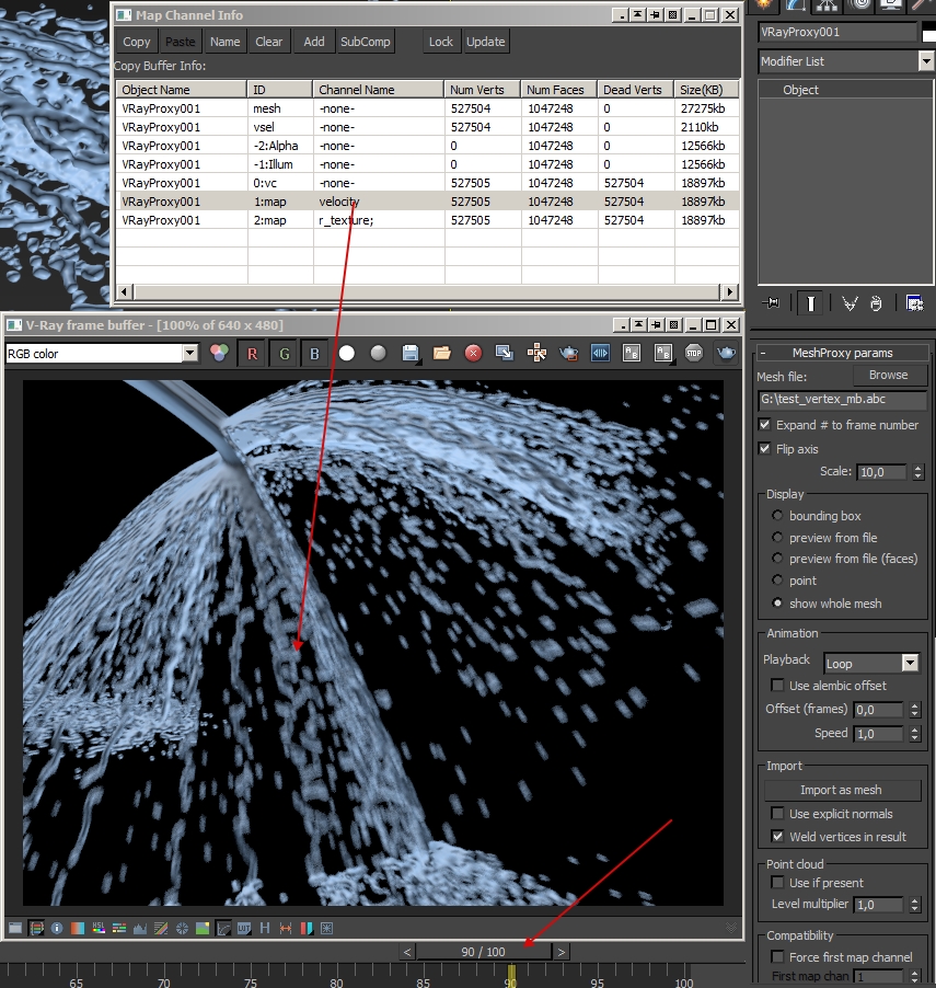

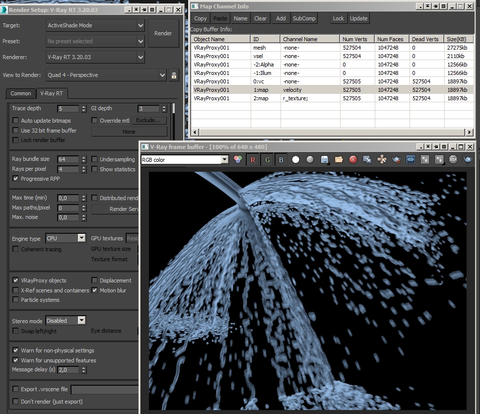

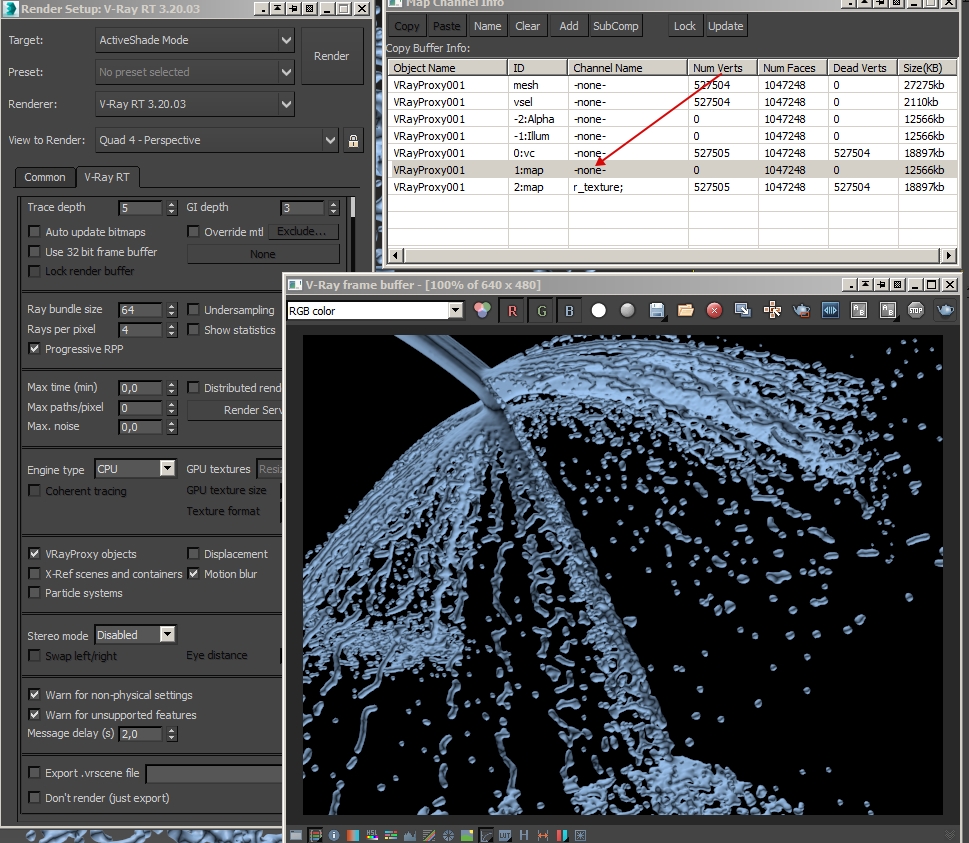

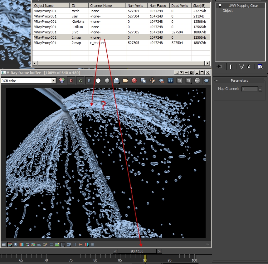

Are you sure? after clearing velocities channel. How is it that, nothing is generated?JimStar wrote:In contrast to that (again, as I already mentioned previously) - e.g. VRay does not need this velocity channel supplied from outside too.
How can it work without data on velocities channel? Where a render can take this information? As renderer can generate velocity information if the first frame number vertex = 1, and in the last their 100, trace location one vertex in neighboring frames not succeed.
Here in this forum thread becomes clear that the velocities information is needed renderer. http://forums.chaosgroup.com/showthread ... velocities
I suspect that you're lying. If information is generated by the renderer, why it does not produce on the geometry directly from 3DS Max. Why did import the file through a proxy? I think the vray developers have done this on purpose to circumvent 3DS max, namely, the error of which you speak, and get velocity data directly to the render.
