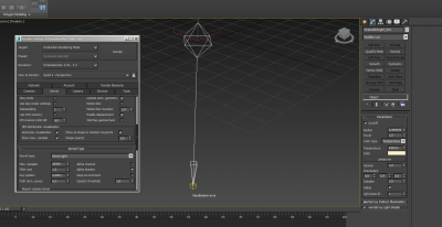

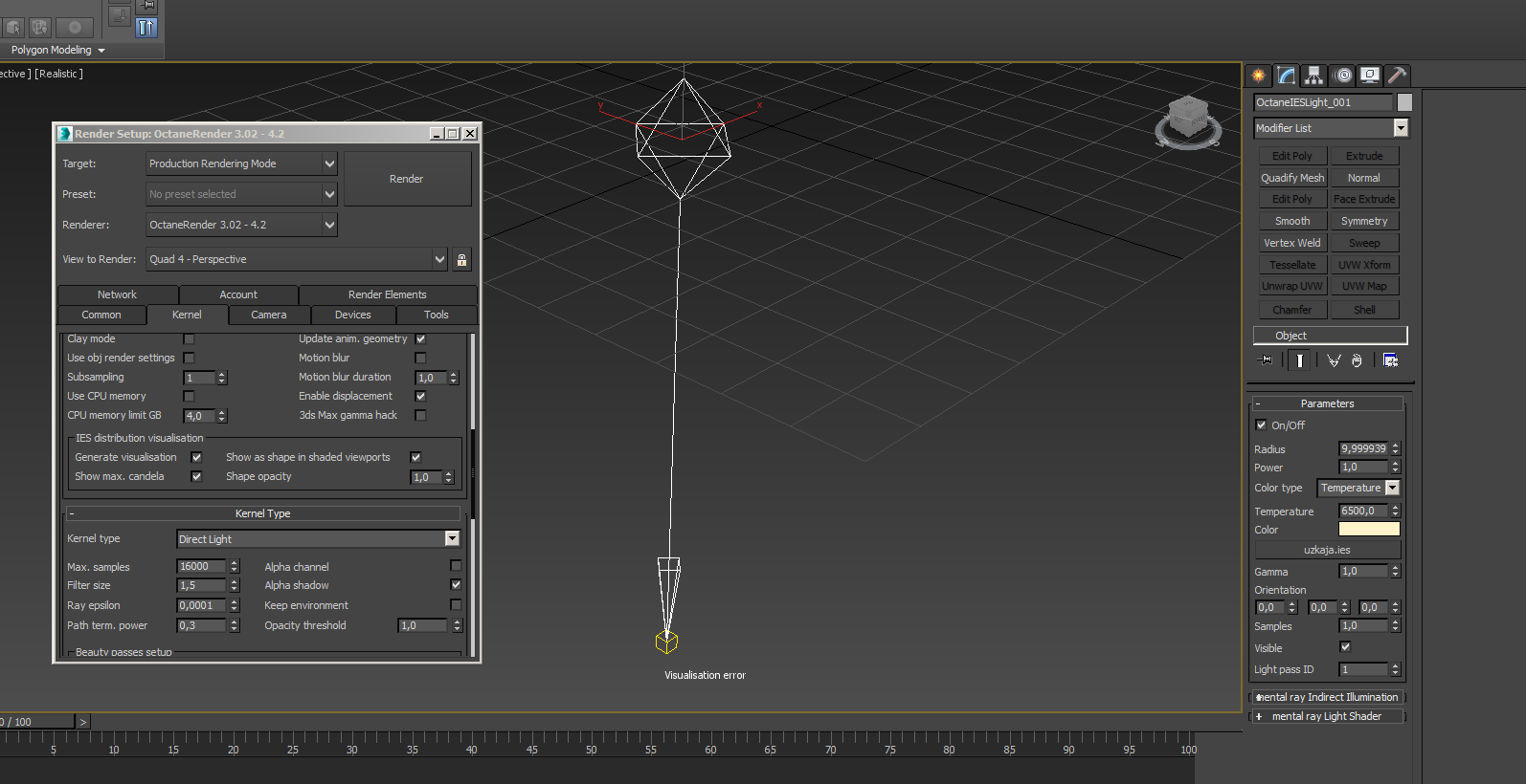

IES distribution visualisation (3.02 -4.0-4.5) not work

Ies LOG 4.3
Started logging on 06.07.16 13:58:03
OctaneRender 3.02 (3020000)
ERROR: IES vis: can't read META: "1 853.00 1 91 1 1 2 -0.090 0.000 0.000"

3.02 -4.3
ERROR: IES vis: can't read vertical angle #1

bug IES --4.4JimStar wrote:3.02 - 4.3 or 3.02 - 4.4?
- Elvissuperstar007
- Posts: 2604
- Location: Ukraine
- Contact:
16 not workJimStar wrote:Is it with any IES file on your system, or just with some of them? If with some of them - could you give me this IES file?
30 work

Ies 16 (3.02-4.5) not work
Started logging on 08.07.16 11:56:41
ERROR: IES vis: can't read META: "1 13172.61 1"
