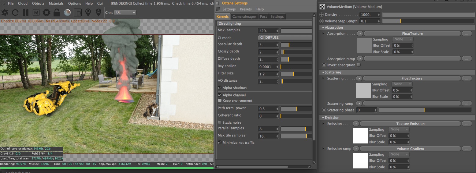

render a TFD fire + smoke with alpha
Posts: 10623
Hi bertritude,
the issue was in the volume medium, with black absorption and scattering, the fire becomes invisible, but it's still there. Just playing a bit with the setting to bring up the fire:
ciao beppe
bertritude
Posts: 143
Joined: Sun Aug 09, 2015 4:30 pm
Waouh, you rules ! It works now. I understand better now. Many thanks for your help .
