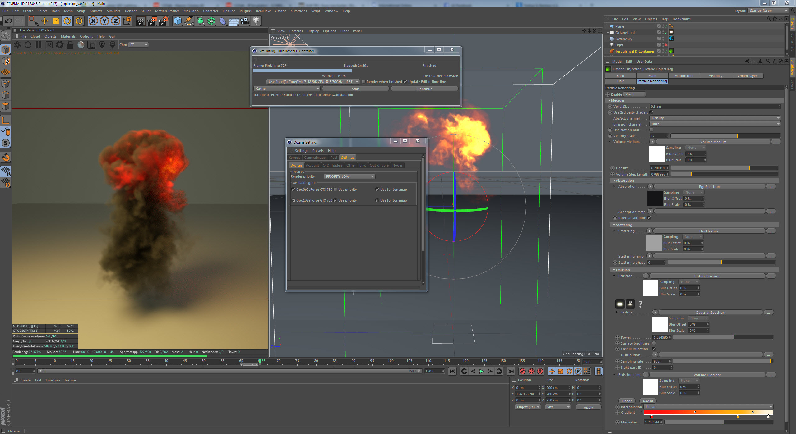

cocobrain
Posts: 10
Joined: Wed Dec 31, 2014 6:32 pm
Thx Calus !!!
I had just found the VOLUME STEP LENGTH in the Volume Emission Editor....
sorry needs more practice !
Nevertheless, I did a rough test following Casey 's NAB presentation and it works fine
