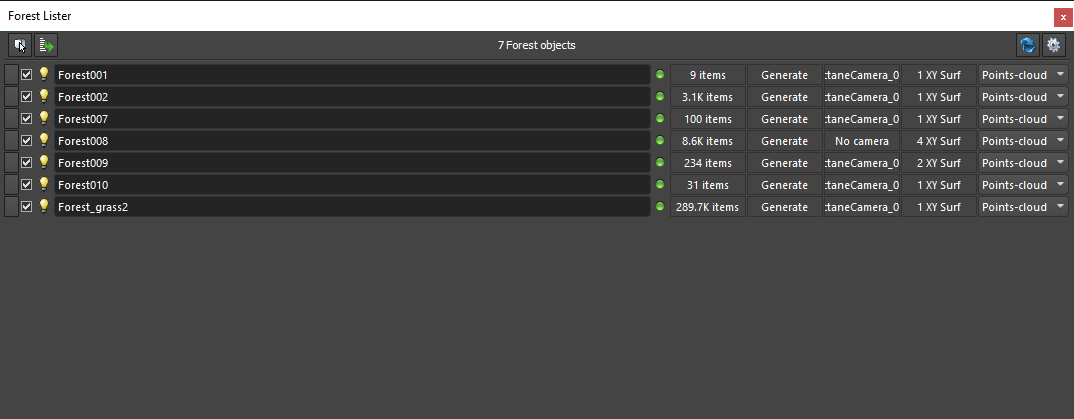

I just was not able to see any difference with a scene with 150 FP objects. What amount of FP geometry is in your scene?
DonFarese
Posts: 74
Joined: Thu Apr 30, 2015 5:05 pm
My scene is large, looking in Forest Lister it shows just the grass to have 289.7k items. Below is a shot of the Forest Lister. This is the same scene that the exposure doesn't save correctly from the other forum.
