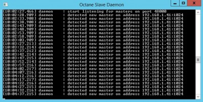

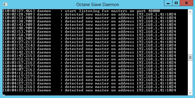

And there's more..
Here the slave somehow believes there's a master at 192.168.1.41
That address belongs to a disabled nic, and even if I change that ip and disables the nic again the slave still thinks there's a
master there.
Why doesn't the slave verify that there's actually something responding at the address it got from god knows where?
How does Octane handle multiple NiCs?
