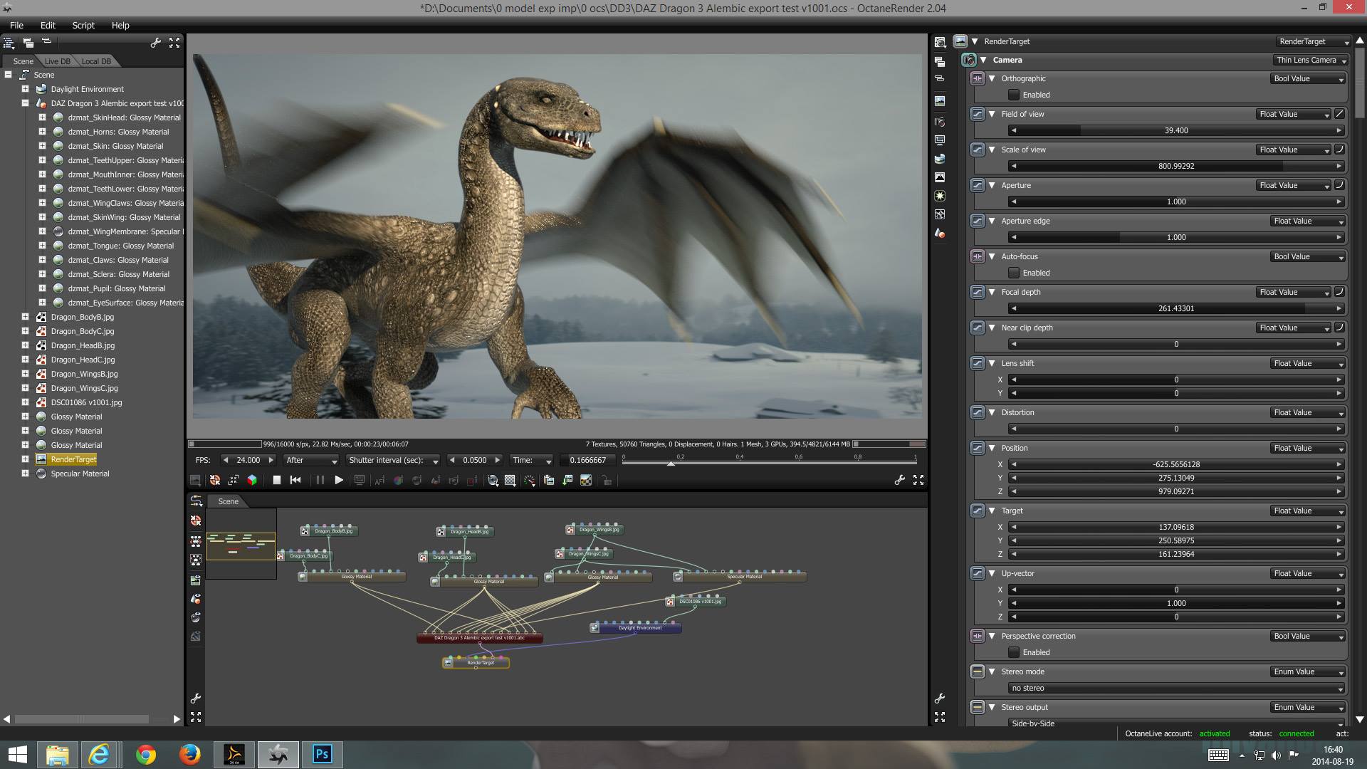

Thank you for taking the time to explain.
In that case people (including me) were asking for Vertex motion blur in OcDS blur to produce images similar like this without having to export.
Example:
- Frame 1 wings down
- Frame 10 wings up
- export to standalone
- move the timeline until you find a spot that looks about right for the effect you want to achieve
- render out the image
It may take a bit of trial and error to figure out how many frames you need between start and end of movement so you can achieve blur effect you want.
-> That is why it would be more comfortable to see the effect directly inside the OcDS viewport.
It would be quicker to adjust the settings and then seeing the result immediately in real time.
That would require the DAZStudio SDK provide the velocity or speed for each vertex, which is doesn't. So the most viable solution is to use the export animation option and render in Octane Standalone.
