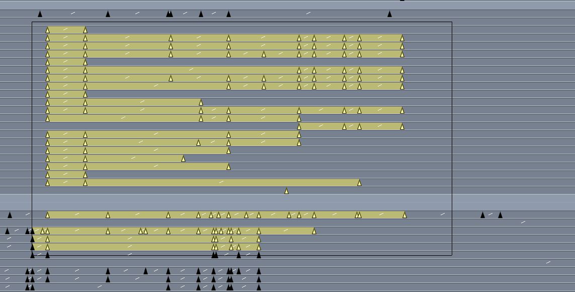

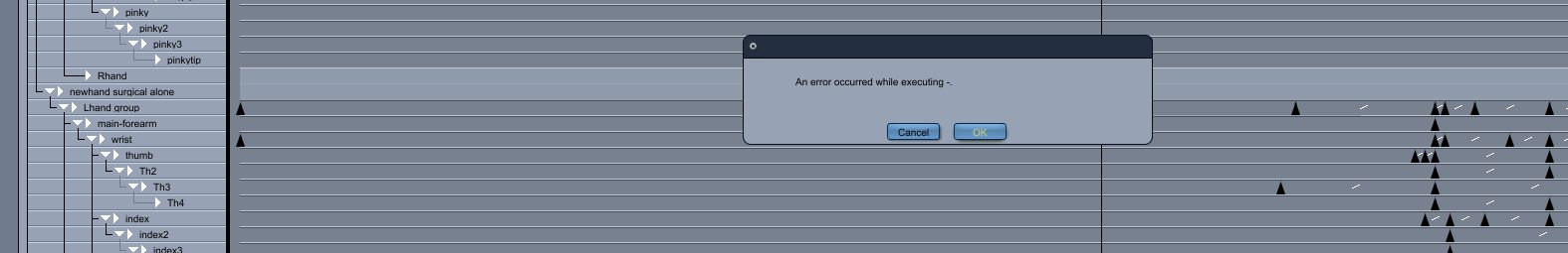

I am encountering an error in this and the previous 3.x version. This error is intermittent and very disruptive. When trying to marquee on the sequencer, the error presents.
I have tried to figure out how to stimulate the error and have a clue that may mean something to you:
1. it seems, that I can make the error happen following a file save.
One other clue: this was a regular error with my first 2.0 Octane versions which seemed to correspond to Materials that were not fully switched over from Carrara Shaders. For example, the Shader tree might have "Multi-Channel" instead of "None" below "Octane Material". Or, a "Layers List" element might have been hiding in an Octane Material.
Final clue: This issue was completely resolved in the previous, last 2.x version. So resolved, that I could accidentally have a Carrara polluted Octane Material, and there would be no issue, nor error.
I am hopeful you can address this soon as I am in a heavy project now.
Thank you for your help,
Rick

Marquee is the term for using the cursor to describe a rectangular shape which surrounds keyframes and the tweens between the keyframes. The ability to select multiple vertical and horizontal keyframes and tweens for more than a single object. The multiple selection can be moved and adjusted horizontally, maintaining important timing relationships.

Note: I may have found another clue/work around. As you know, the error comes up after a file save. I just stimulated the error, and as an experiment, held the shift key down and selected multiple sequencer items, one at a time. Then, and I have only tried this just this one time, I was able to successfully marquee. Maybe this can get me through......
