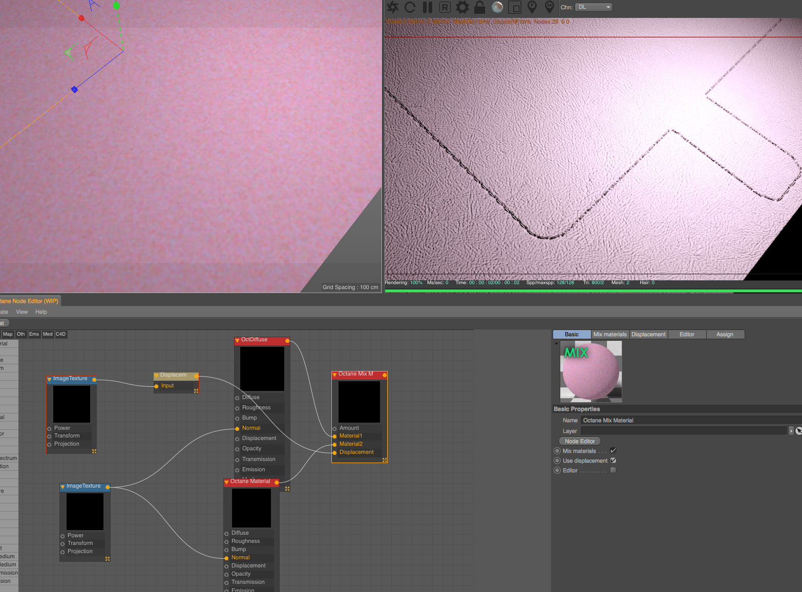

unfortunately this is not exactly working as the Normal still produces a 'tiling' artefact when displacement is enabled..
you can see it ore clearly here:
normals tiling
normals tiling
normals fine
normals fine

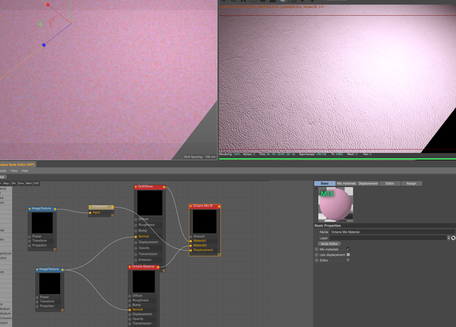

normals fine
normals fine
normals tiling
normals tiling

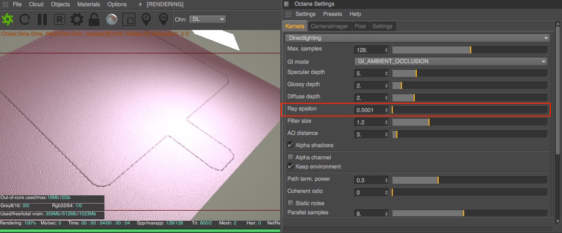

I see, but I cannot reproduce the effect here with your scene
Anyway, sometimes it could be necessary to correct the Ray epsilon value in the Kernel settings when you see artifacts:
ciao beppe

but it really looks to me like the normal is still tiling in your screen grab..
if you try turning off displacement you'll see how the normal is supposed to appear.
I did mess around with the ray repulsion thing with no success.

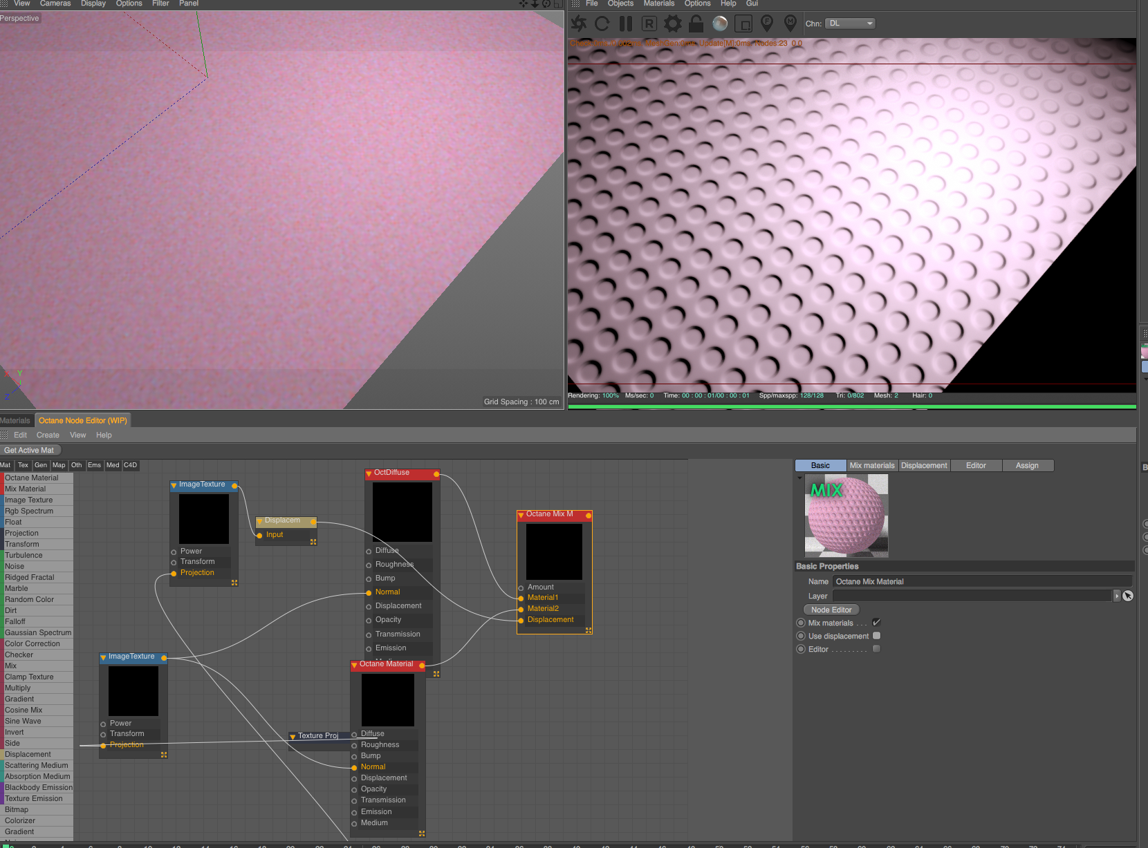

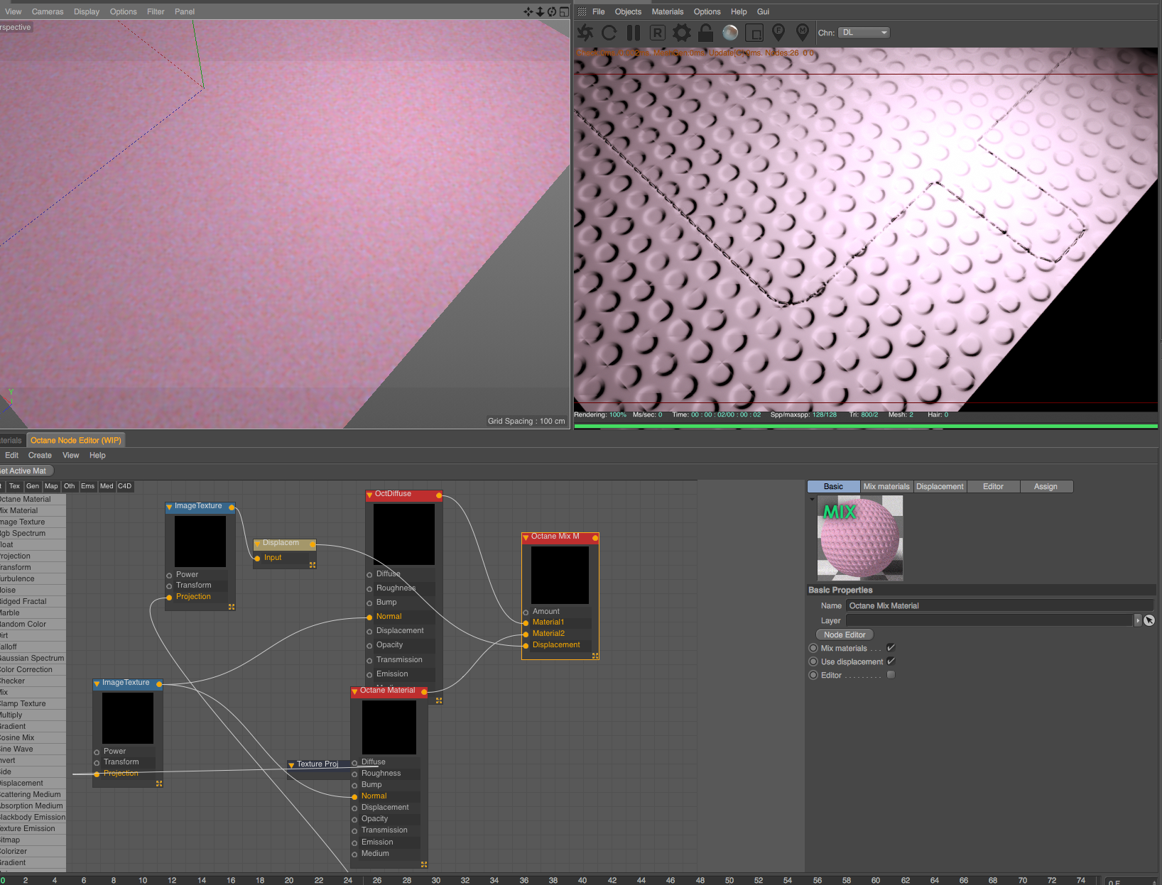

here are 2 screen grabs with a simpler NRM map to better show whats happening.. you can see when displacement is turned on how the normal map has artefacts.
disp ON
disp ON
disp OFF
disp OFF
