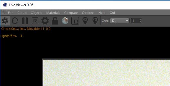

Cinema4D crashes when I run the Live Viewer. exactly on this point: Lights/Env. 4 (I attached the printscreen)

urtcor wrote:Thanks for your reply.
Did you tried with 3.06? I think this set has a lot of C4D shaders/layer textures. This is not adviced usage and can cause crashes.
