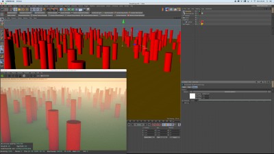

muchogrande wrote:Is this possible in C4D? I can't find a way to add a Schlick node in the Phase slot...?
I've messed with the fog medium in the daylight object for days, never reached a desired result...It seems to go from fully engulfed fog or no fog.
Can never get that fade on the horizon...

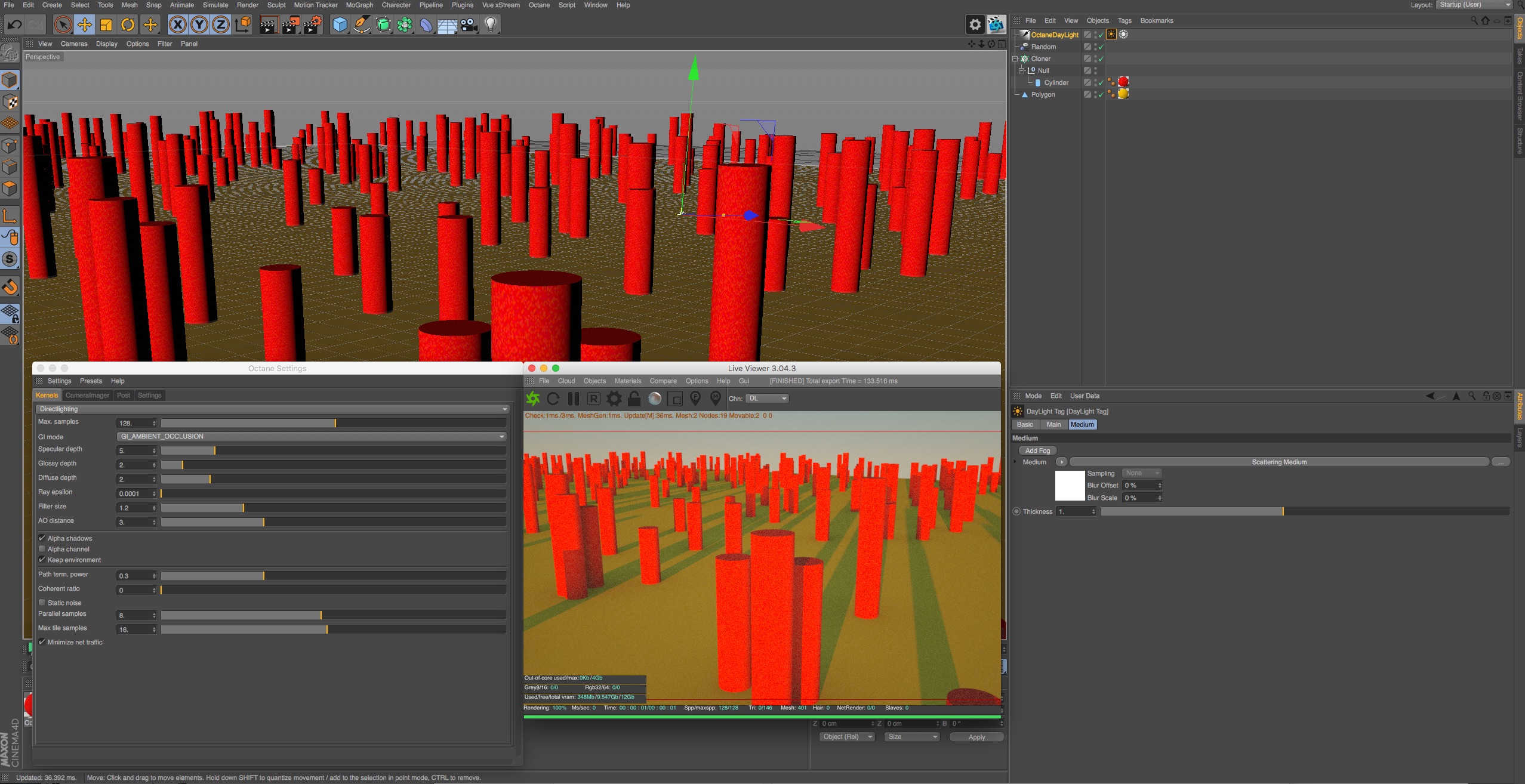

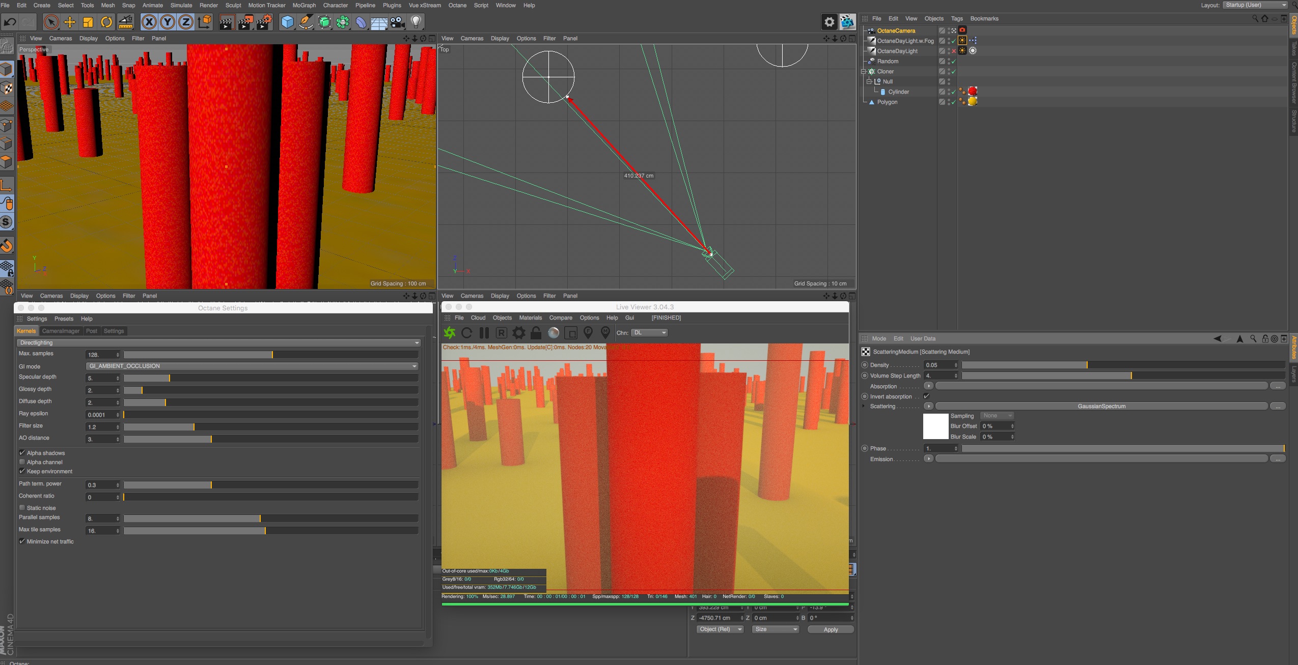

Hi mikeadamwood,
the Thickness in the medium tab has a great impact in the fog effect, since it must be set accordingly with the scene dimensions. Sorry, I was not able to find the old test scene. Please look at this other simple example with Scattering value at 1:

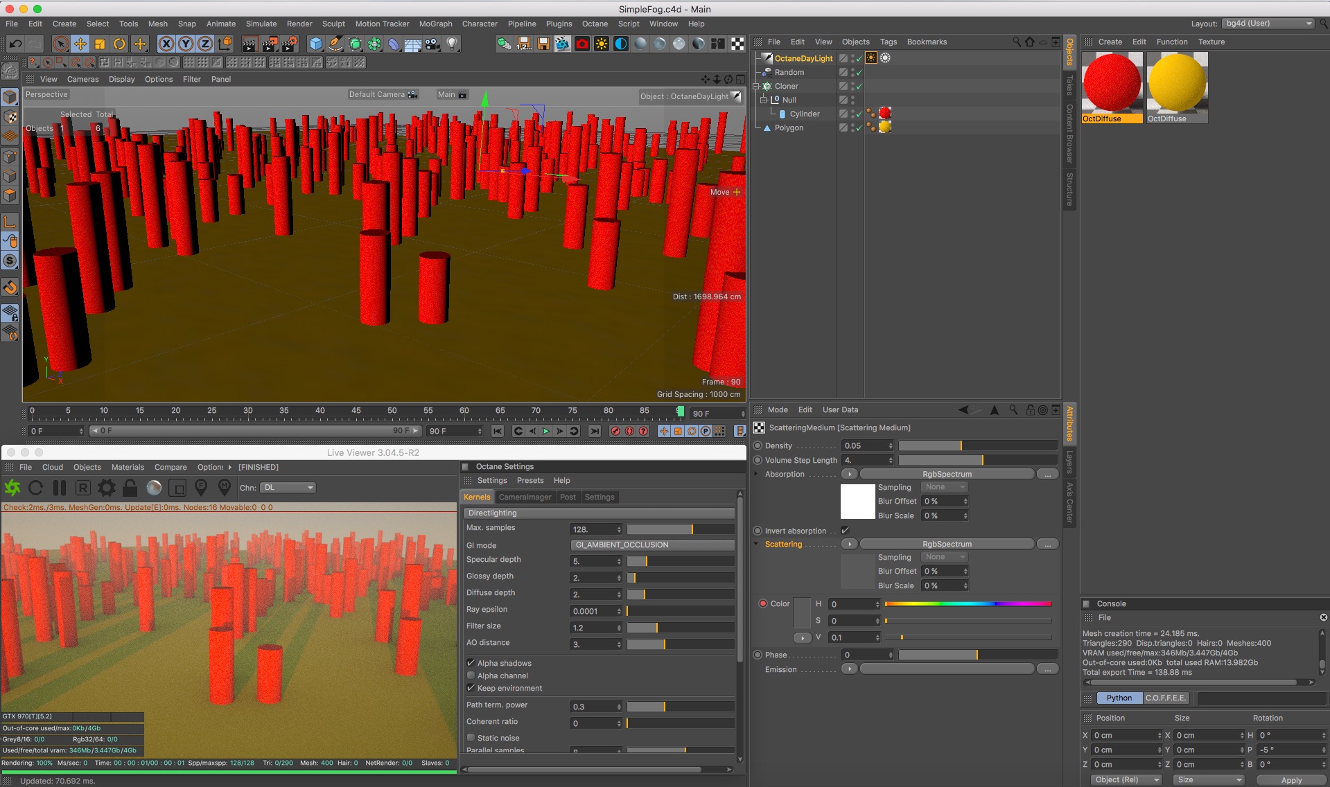

Ad at 1.0:
Here is the scene:
SimpleFog.zip
(113.87 KiB) Downloaded 323 times

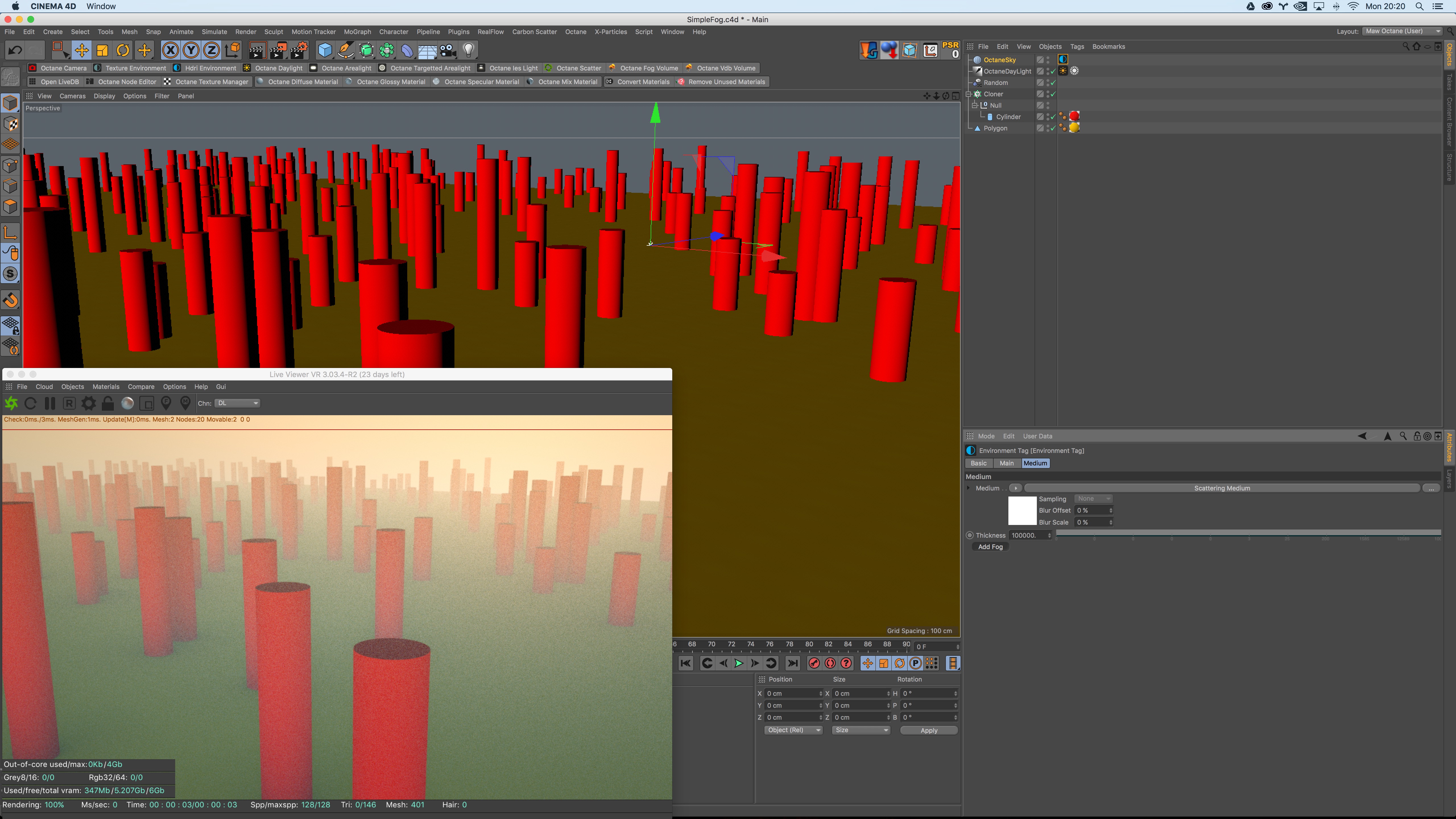

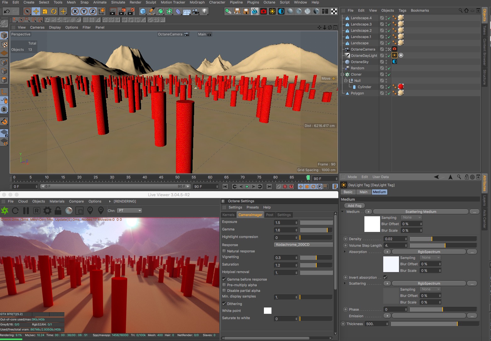

Thanks for the scene Beppe, but for some reason it is not rendering the same for me as it is for you. Thickness of 100 looks the same to your render, but Thickness of 1 gives me no visible fog at all. I found that adjusting Phase in this demo scene did very little to adjust the density of fog near the camera. I am on 3.04.3 OSX.
The Phase issue is still confusing for me and I would love to have a better understanding. I have had some success using your demo scene from earlier in this thread (FogTest.7z) - which uses a GuassianSpectrum node in the Scattering property and leaves the Absorption property empty.
But I find the Phase parameter limited in what it can accomplish. At Phase=1 if the camera is more than 400cm away from a FG object it becomes foggy. Is there a way to push the fog start further back from the camera?

I'm getting fairly decent results with this, I did ramp up the density max, not sure why...I know its me but this just doesn't seem to make sense, slider seems to have extreme results.
muchogrande I am on OSX too, could this possibly be a problem with the Mac version it seems strange we have varying results.
bepeg4d is there a way to achieve it blending into the horizon? Is this even possible with the fog? I mean to my current knowledge you can only achieve fog which engulfs the sky so losing the sky texture.

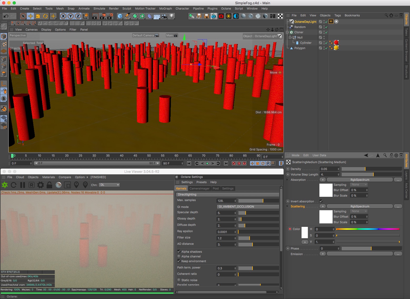

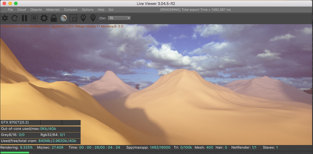

Hi mikeadamwood,
sorry for the misunderstanding, the thickness must be set based on the scene dimension, then you can play with all the parameters inside the scattering node.
Here is a fast example of distance fog with Physical Sun + HDRI:
ciao beppe

Hi mikeadamwood,
yes working in real dimensions is always the best in Octane and the thickness is measured in meters.
About the previous example, it also depends from the direction of the light, if the sun is in the opposite direction, there is less diffusion of light:
