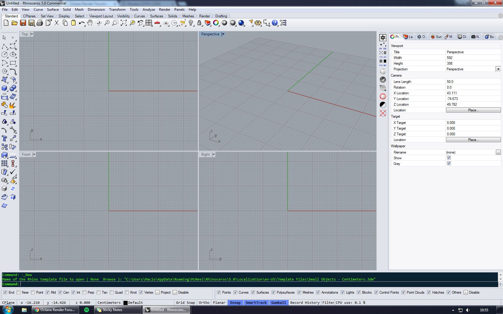

prehabitat - yes. I'll add more features in the future so they would go underneath the current icons (or cascade icon/menu when it gets crowded)
I have it like this:
If you guys have any suggestions for the toolbar post them in this thread
Add materials with one click - toolbar

I just added toolbar for octane for rhino 3.x.x .
Download link is in the first post of this thread.

Hi formatio,
your toolbar is great.
Unfortunately materials don't work. Rhino says: Unknow Command
I' seem like "RenderLoadMaterialFromFile" isn't recognised...
Bye
Bye
Hi Fabrizio.
This command comes from rdk - do you have it installed/up to date?
This command (and many others starting with Render...) do not autocomplete.
Regards,
Mac
Regards,
Mac

I have solved...my Rhino is in the Italian version...so I have to insert an underscore before the commands.
_RenderLoadMaterialFromFile
Now everything works fine
thanx a lot
thanx a lot
Hi, Thank you for the info - I changed the toolbar so it works in every language now
(see first post in this thread)
