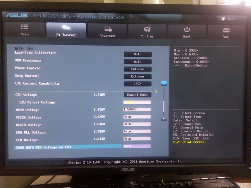

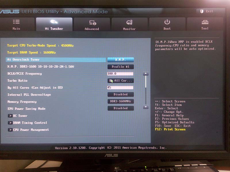

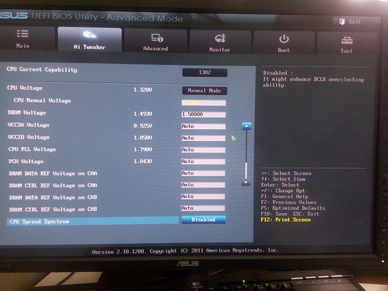

My bios settings - PLEASE DON'T USE IT AS A REFERENCE FOR YOUR BIOS - IT IS ONLY FOR SANDY BRIDGE 2600K (WATERCOOLED).
