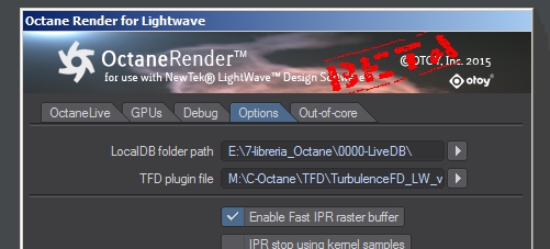

juanjgon wrote:The plugin works with the TFD cache files to render them as Octane volumetrics. You only need to add the Octane_Volumetrics custom object plugin to the TFD container Null object to set the path to the cache files, select the grids to be rendered and set some data about the container (voxel size and grid size and offset). And of course you need to add the scatter and emission nodes to build the volume material in the volumetrics node editor.
You need to configure also the TFD plugin path/file in the Octane plugin options panel.

Attached you have a TFD demo scene. The path to the cache files is set to E:\tmp ... you should change it in the container to any point on your HD, compute de simulation and set the same path in the Octane_volumetrics panel.

juanjgon wrote:Attached you have a TFD demo scene. The path to the cache files is set to E:\tmp ... you should change it in the container to any point on your HD, compute de simulation and set the same path in the Octane_volumetrics panel.
-Juanjo
where in the Octane_Volumetrics panel. It is set to a mode of TFD, I set the same path in the TFD bit and get the error 'tdf library not found in (random characters)". If I set it to OpenVDB, it is asking for a specific file, when I look in the place I've pointed the container to, there are lots of files in there. The most recent one, does nothing.

You need to configure the TFD plugin path/file in the Octane plugin options panel. The TFD cache files are not VDB files, so they can't be rendered using the VDB loader.
