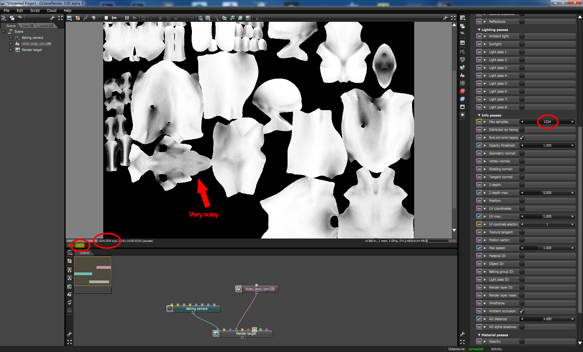

  • The AO Info Pass still has a sample limit of 1024. :cry:

We can increase the value range of the max samples of info passes. Out of curiosity: Can you show me an image where 1024 is not enough?

abstrax wrote: We can increase the value range of the max samples of info passes. Out of curiosity: Can you show me an image where 1024 is not enough?
Check the attachment.

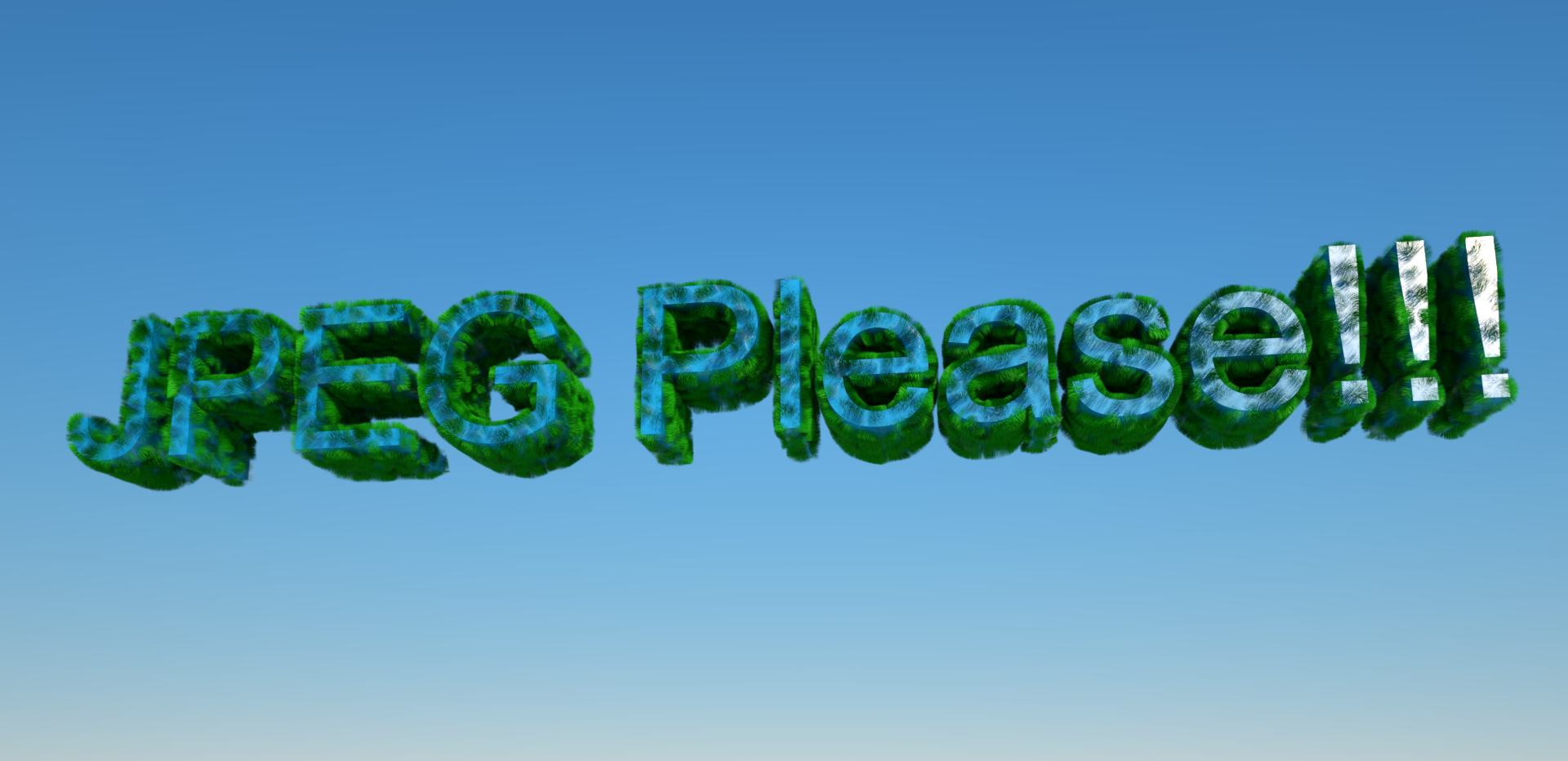

Would it be possible to throw in an export to JPEG option, it would be really nifty to not have to afterwards merge a PNG with a background image in Photoshop and then save as a JPEG if wanted.
You know, if you add a background image in the standalone (while in rendering) and save the file, it is still there the next time you open (very nifty, very handy to have this).
But not having the option to just export that out in one shot is a workflow pain.
The option would be nice...
If this is happening just when using the baking camera might be related to another issue with noise that we recently solved. We can take a look at it if that's the case.
