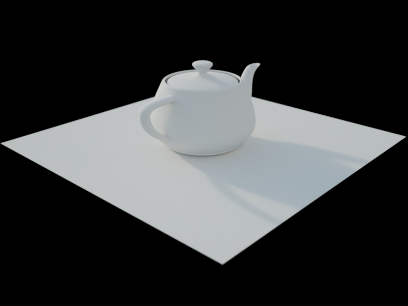

daniel.reutersward wrote:I´m a bit confused here as well.
I don´t see any difference in this version? The material editor showed correct result when 3Ds Max Gamma was enable in 2.15?
3Ds Max Gamma enabled + tonemapping enabled = wrong gamma in Octane Viewport.
3Ds Max Gamma disabled + tonemapping enable = correct gamma in Octane Viewport, wrong gamma in material editor.
Nevermind, I tried and it works correct if I use 3Ds Max Gamma 2,2 and Tonemapping.
Materials in the material editor looks correct and if I use "Linear" response the rendering looks correct too.
What I do notice is that the response curves are not updated to match the new gamma settings.
For instance, when using the response curve "Agfacolor_Futura_100CD" there´s double gamma on plugin version 2.16.
I´ve attached 2 screenshots showing this. All settings are identical, I´ve only installed different versions.
Plugin Version 2.16
Plugin Version 2.16
Plugin Version 2.13
Plugin Version 2.13

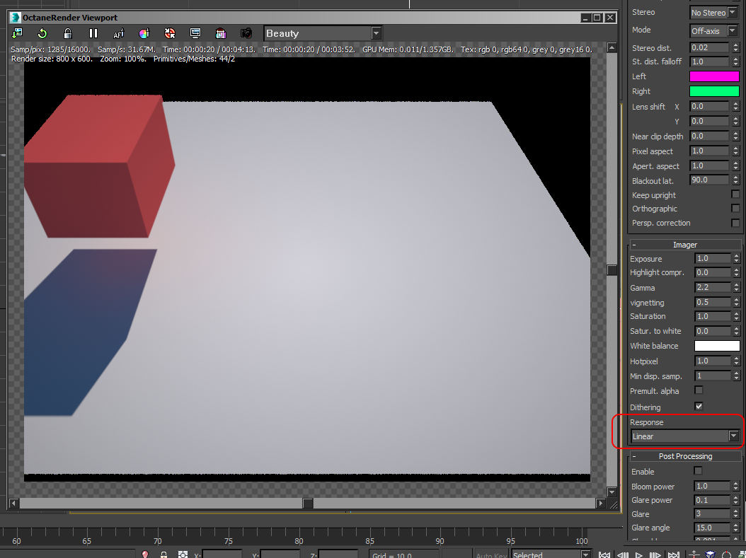

3ds Max plugin, "Linear" response:

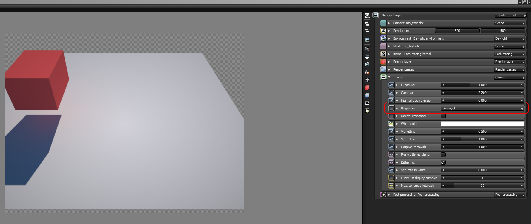

Standalone, "Linear" response:

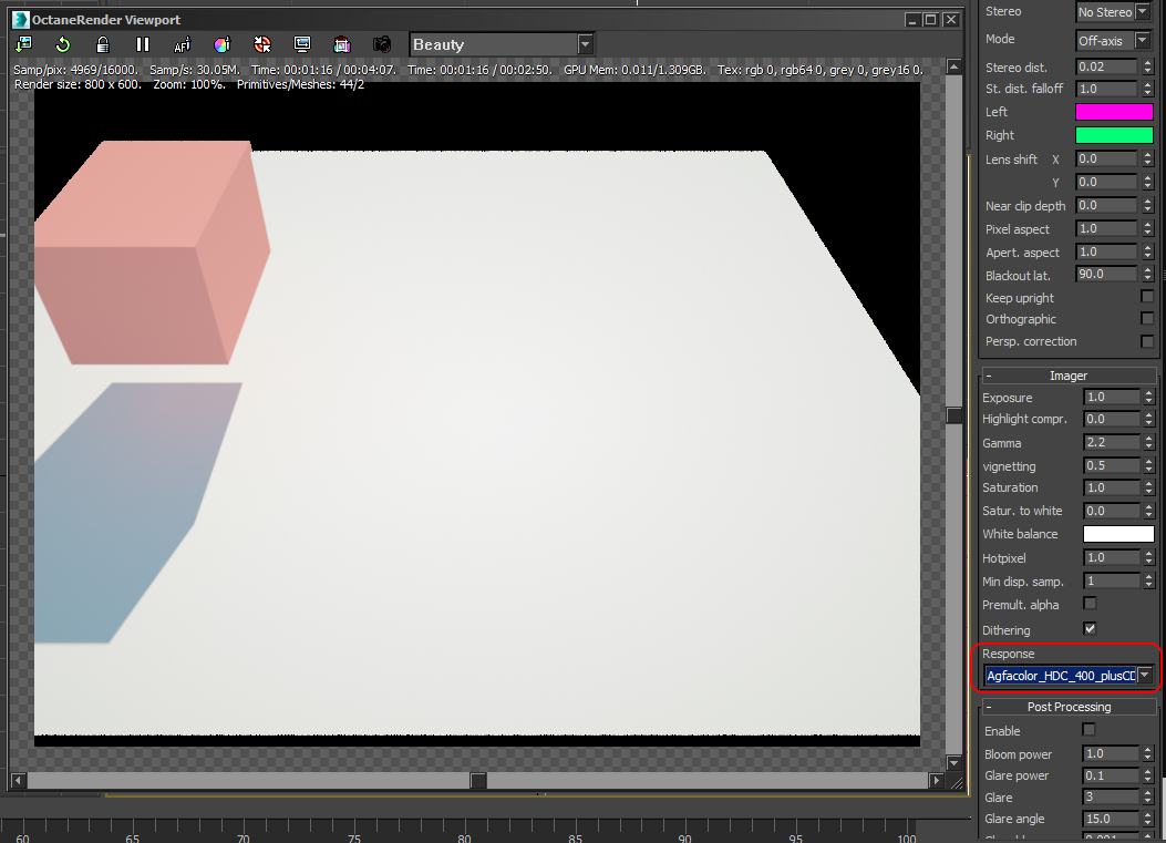

3ds Max plugin, "Agfacolor HDC 400 plusCD" response:

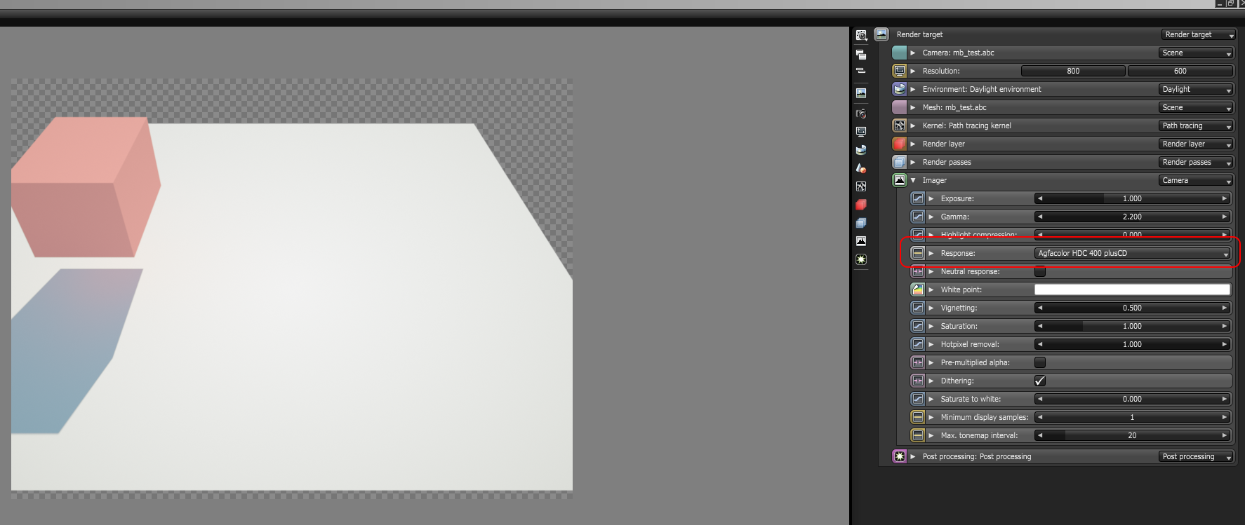

Standalone, "Agfacolor HDC 400 plusCD" response:

JimStar wrote:3ds Max plugin, "Linear" response:
Hi Jim, I don´t fully understand?
Everything works nicely except the response curves/LUTs. They are not using the correct gamma compared to earlier versions?
Or do I have to chose between using 3Ds Max Gamma 1,0 and LUTs or 3Ds Max Gamma 2,2 and Linear from now on?

JimStar
Posts: 3852
daniel.reutersward wrote: I really hope this gets fixed or I´m stuck at 2.13 :P
Have you ever seen the images I posted for comparison with the same standalone results? viewtopic.php?f=80&t=52130&start=10#p261367
Do you mean it should be "fixed" in standalone? This is a wrong thread if so.
