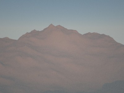

I have not changed anything to do with the environmental medium. Are you sure you are using the same values as before?PhilW wrote: Edit: I just tried the new version and the environmental medium seems to give just a uniform shading to the scene irrespective of depth, so that a near part of a terrain (or anything) gets as much "fog" as a distant part. It was not like this in the previous version.

I have attached an illustration of the "flat fog" in the environment medium, there is no sense of it receding as it is applied uniformly across the whole image. In the previous original version, I was able to get good receding atmospheric haze in a scene like this. I am just guessing here, but maybe this is done by having an inward facing "bubble" around the camera, and somehow the normals on that have got inverted?
