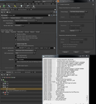

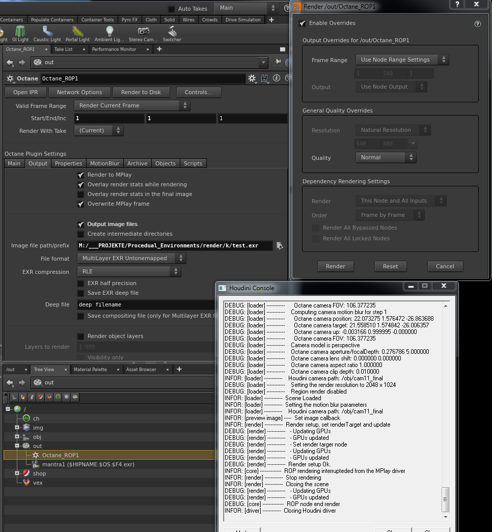

I did a screen capture of the log in a simple test scene with just a cube and an octane-shader.
It says that the Mplay driver interrupts octane. All the while the IPR continues to work fine.

The log in my previous post shows what happened after pressing Render in the controls panel.
Basically IPR is the only way I could initialise a render with octane. Unlike the mantra-ROP the octane-ROP has no "render to mplay" button and

So I tryed to initiate the rendering through the main menu, which didn`t make any difference.
After the log says "set render targer (target?) node" I can see the RAM usage rise and fall like it does before IPR but instead of rendering it stops then.
