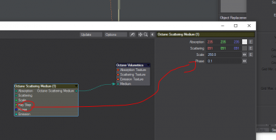

Wrong label name, instead of phase there should be ray step and so another one should be added named phase.
