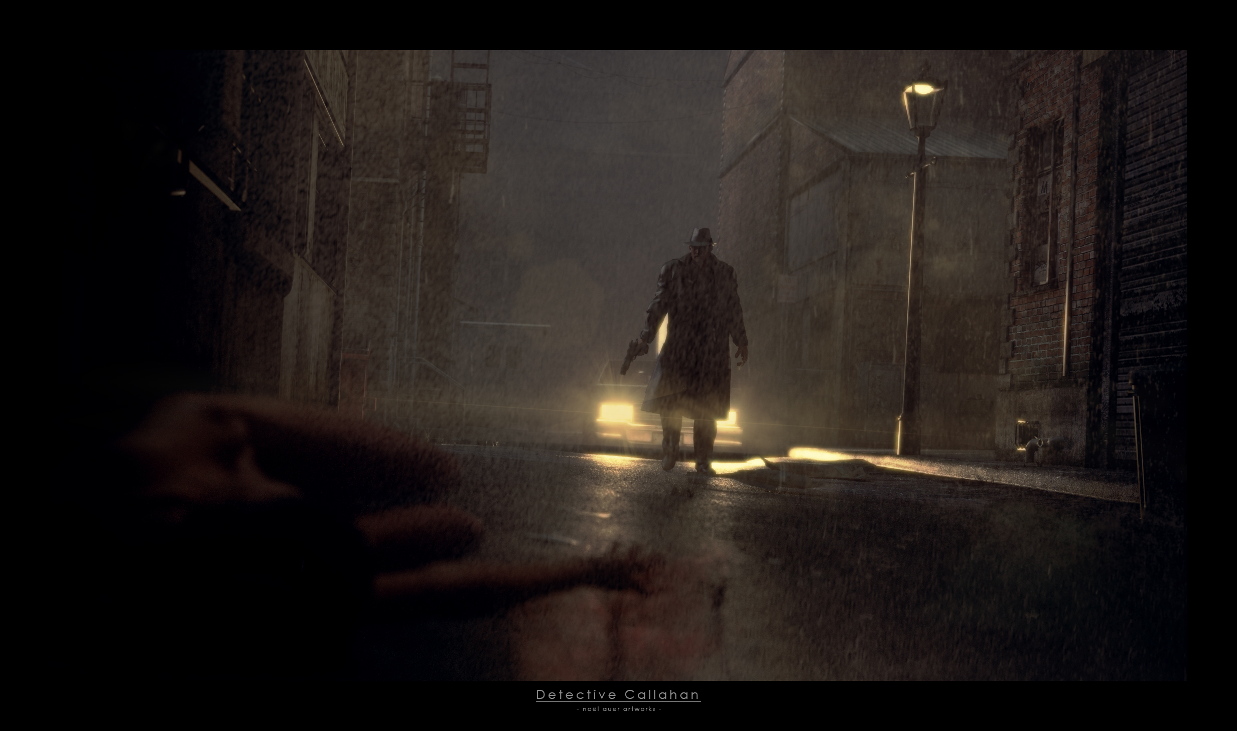

How does this work with spot lighting where the scene is lit in a few places to create a noir look? Is it correct in OcDS scenes to light the scene brightly all over and then light specific areas even brighter with spots and then lower the ISO to darken the scene down?
You got it!
That's exactly how you do it. This way, there is lighting information present in every place of your scene, which makes it easier for the renderer to pick up texture and shader information.
Edit: Speaking of noir - I applied the exact same technique a while ago in the render attached.

That's a great render and exactly the effect I'm after. It does seem counter-intuitive to over light a scene but if it prevents the dreaded hot pixel problem then job done.
