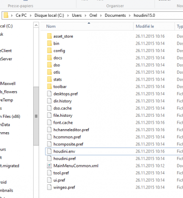

a screen capture
it's right?

In Windows 10 all should work fine. Don't you have a houdini.env file in your Documents/Houdini15.0 folder, where you have put the plugin folders?
i placed all together with houdini.env, in the same file.
juanjgon
Posts: 8867
Location: Spain
Ok. I was wrong, my mistake, sorry.
Even if you copy all the plugin folders in the Houdini $HOME directory, you must edit the houdini.env file and add the PATH line:
PATH = "C:/Users/Orel/Documents/houdini15.0/bin;$PATH"
Please, add this line to the houdini.env file and try again.
-Juanjo
