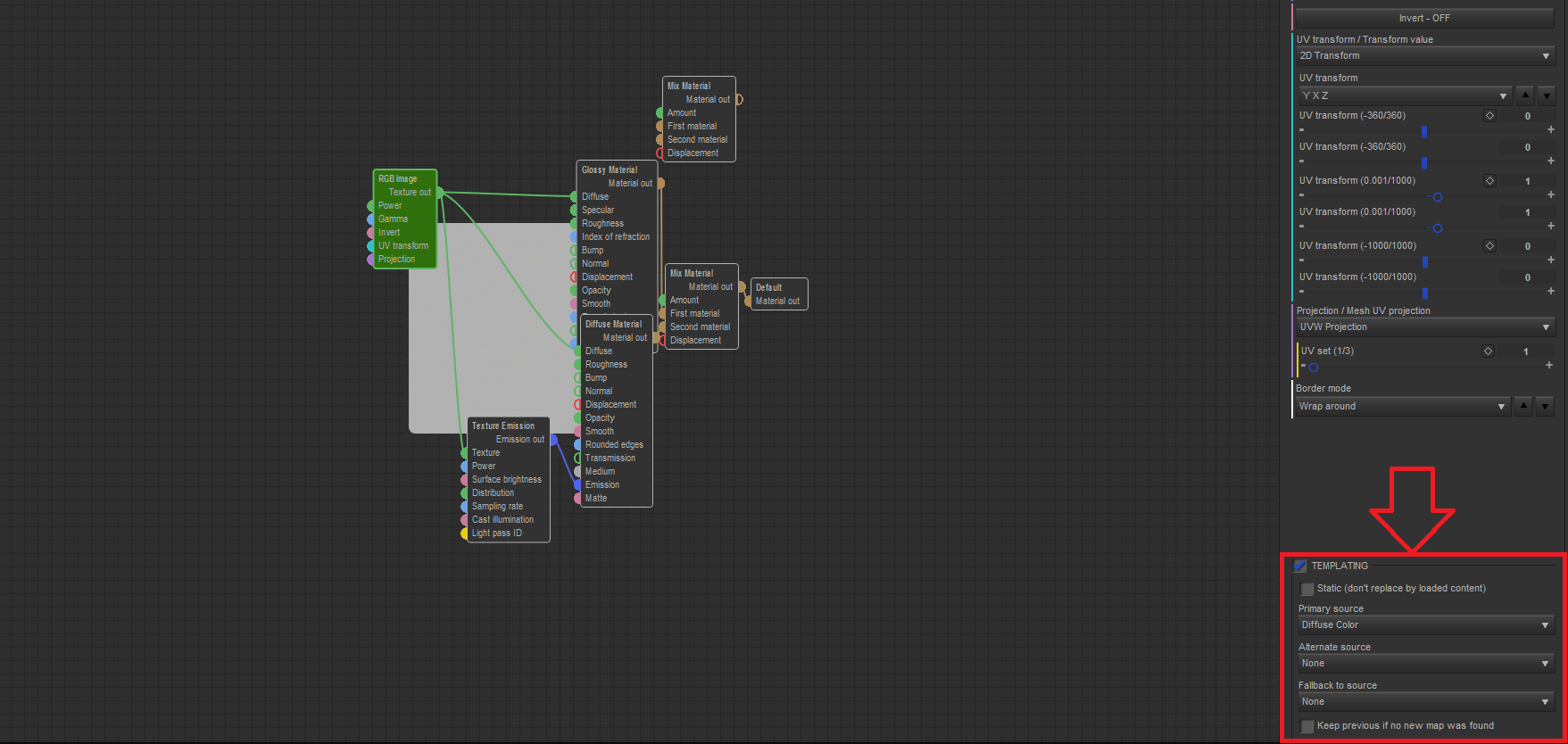

sikotik13 wrote: If this is set to some other map or none (or static, since that keeps whatever it is, and ignores maps entirely), that would cause the same issue.
I double checked if adding a checkmark at "Keep previous if no new map was found" would change anything.
No luck with that.
I guess we may find solutions or other limitations when more people start using templates and are trying to save them as DAZ Studio material presets.

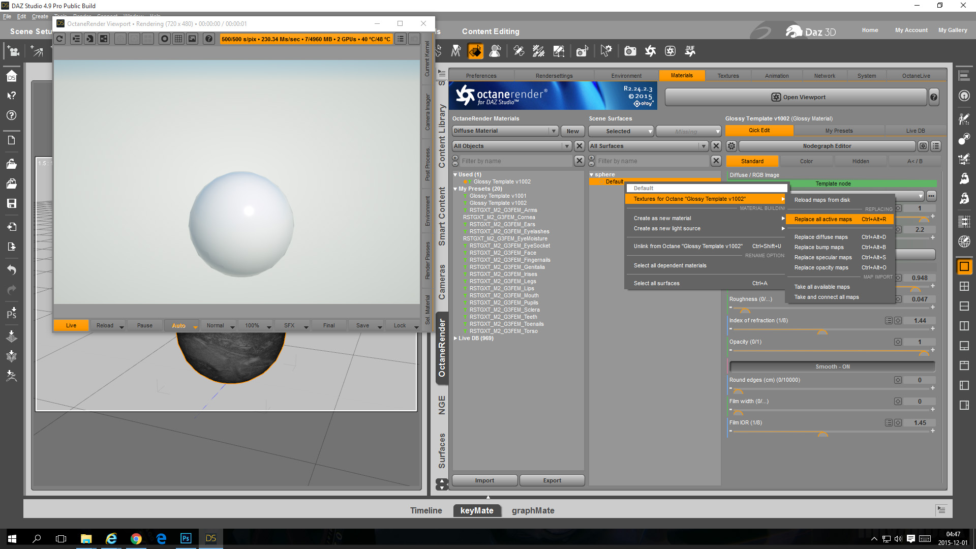

Replace maps - simple template material workflow
The "Replace maps" feature makes it possible to work around the limitations when saving OctaneRender materials with template nodes as DAZ Studio material presets.

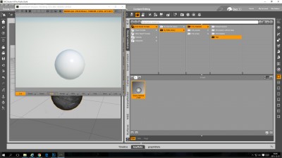

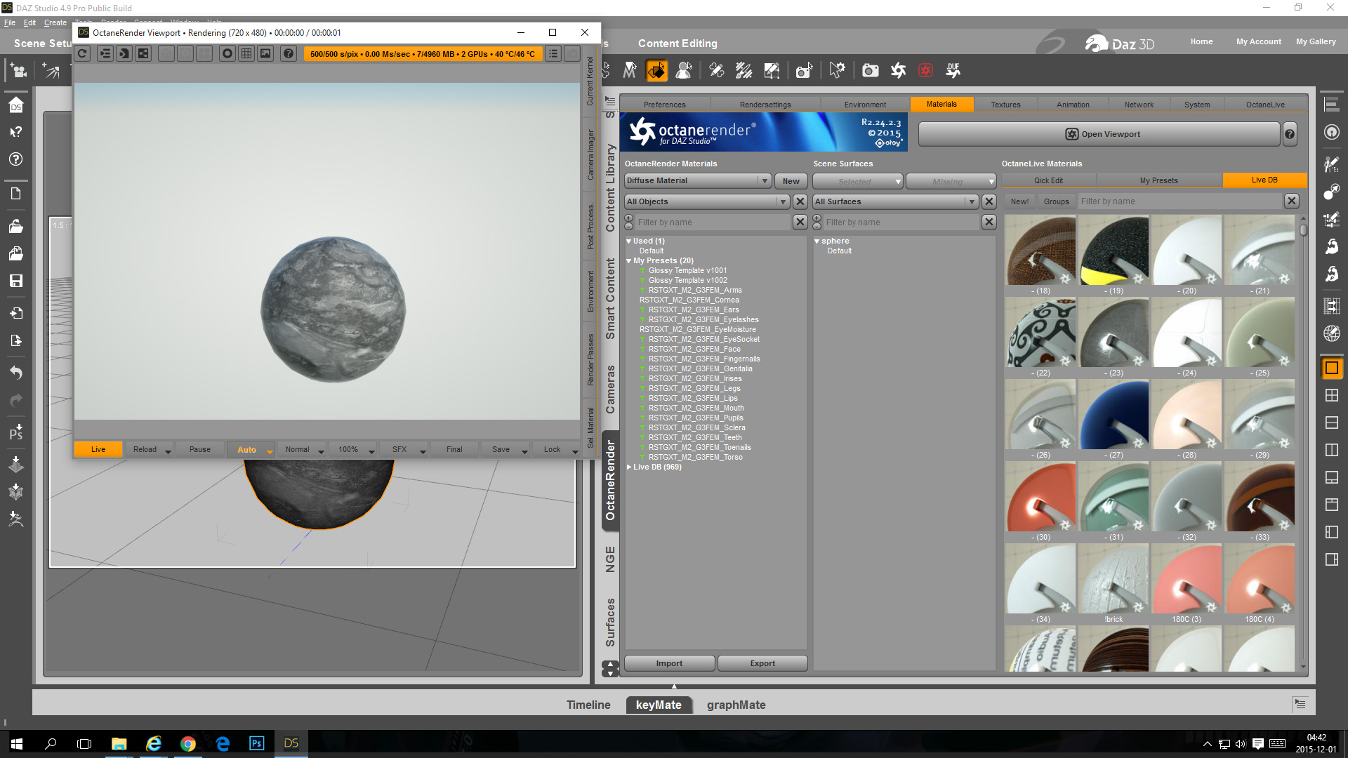

- 001 OR material after auto conversion

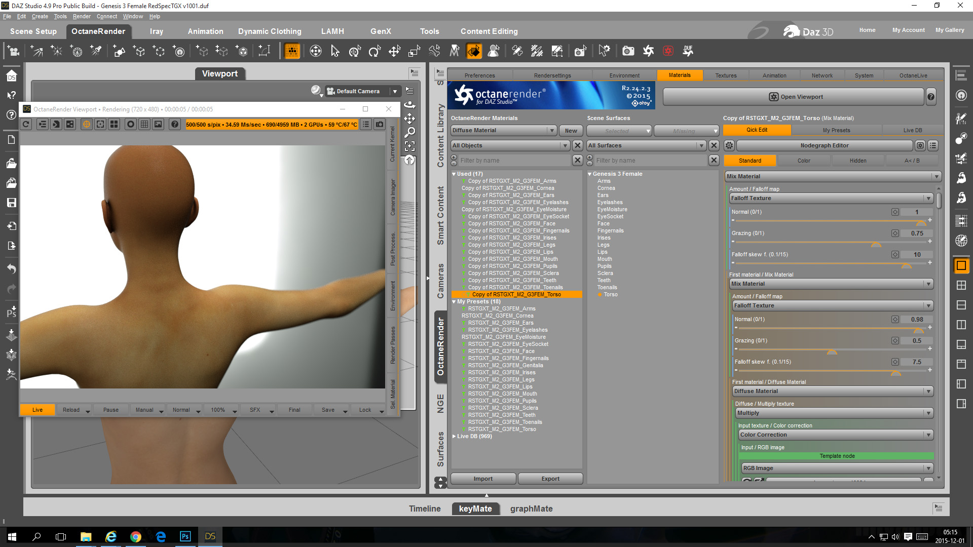

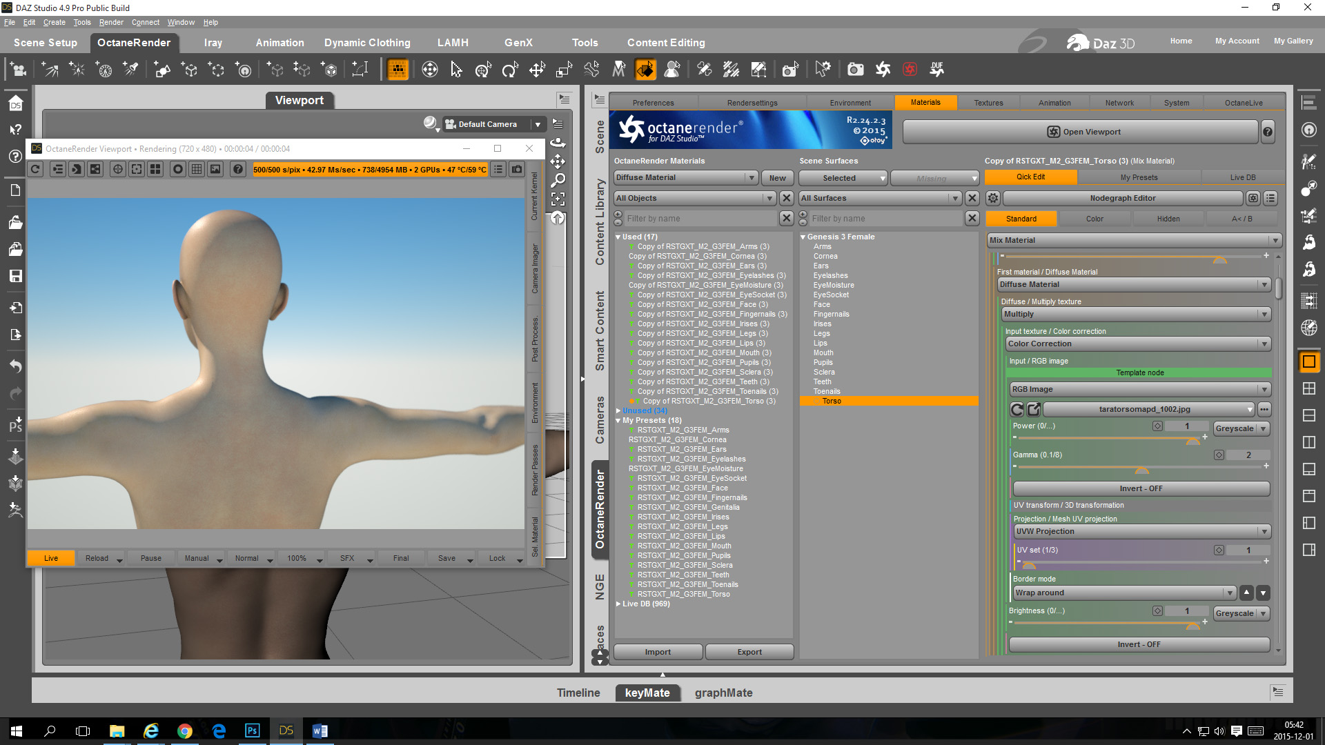

002 applied DAZ Studio material with template node

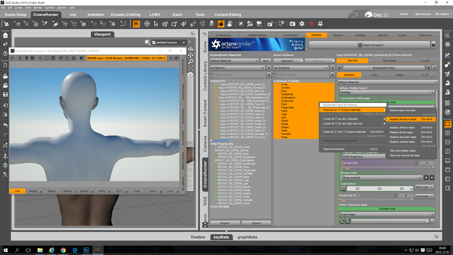

003 right click option - Replace all active maps
004 End result - template material combined with map in DAZ Studio surface tab
004 End result - template material combined with map in DAZ Studio surface tab.jpg

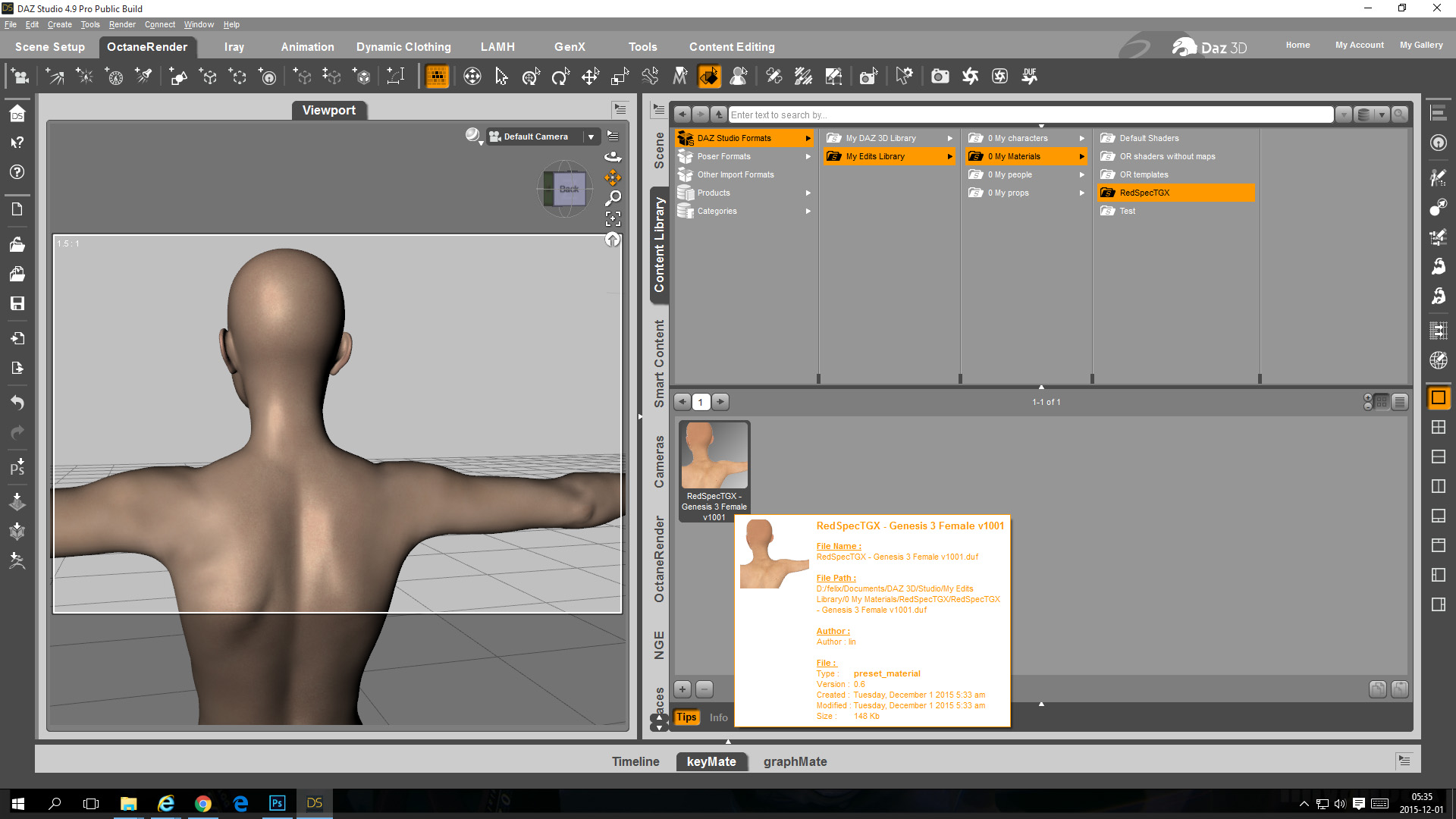

- click on the saved RedSpecTGX DAZ Studio material preset
- select all surface zones in OcDS
- right click and "Replace all active maps"

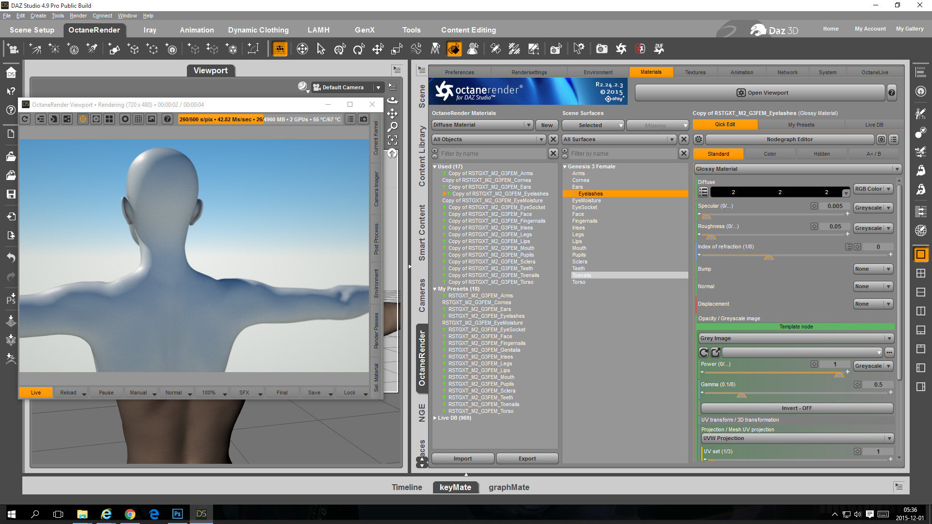

001 apply Genesis 3 Female RedSpecTGX to all surface zones:

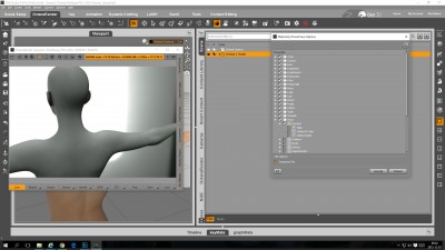

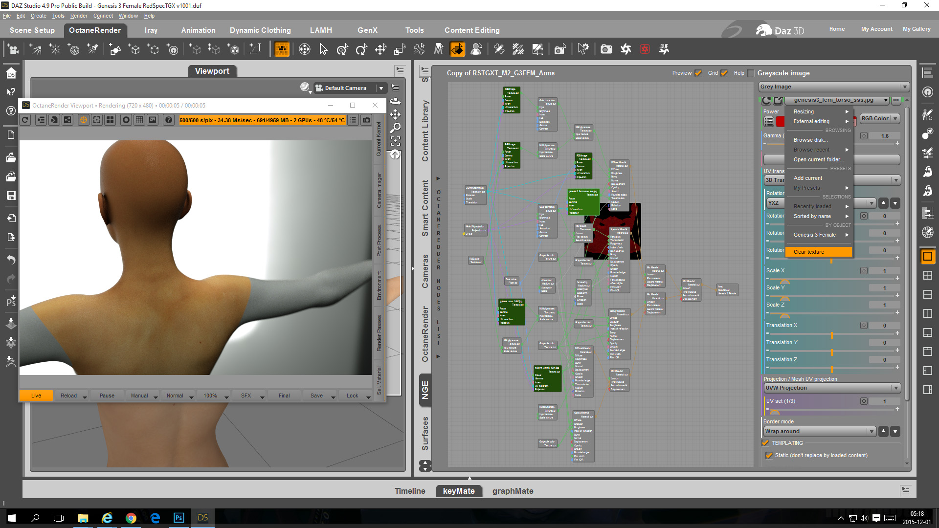

002 use the clear texture right click option to remove all applied textures from the template nodes:
002 use the clear texture right click option to remove all applied textures from the template nodes.jpg
Step 002 may be optional.

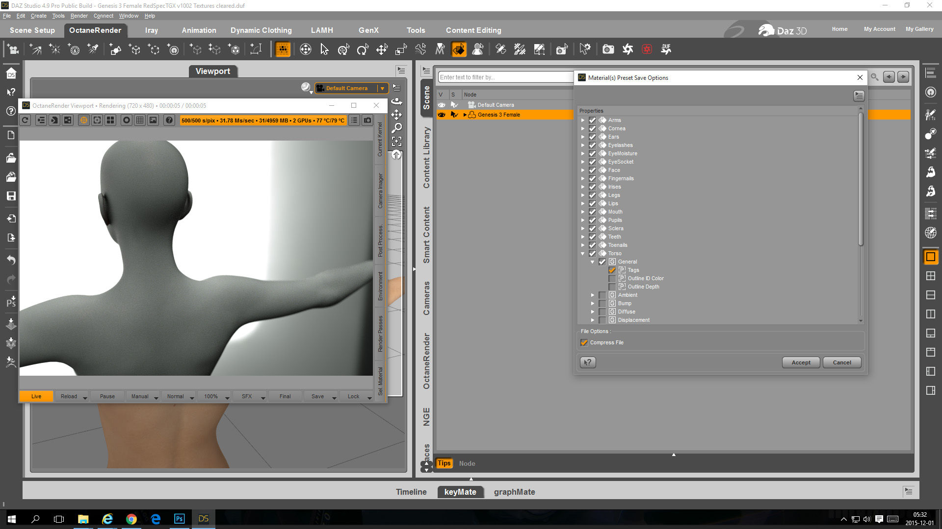

003 save as material preset - make sure to only select the option "tags" on each surface zone

004 apply DAZ Studio material preset

006 Use CTRL +A to select all surface zones and right click the selection and choose "Replace all active maps"
