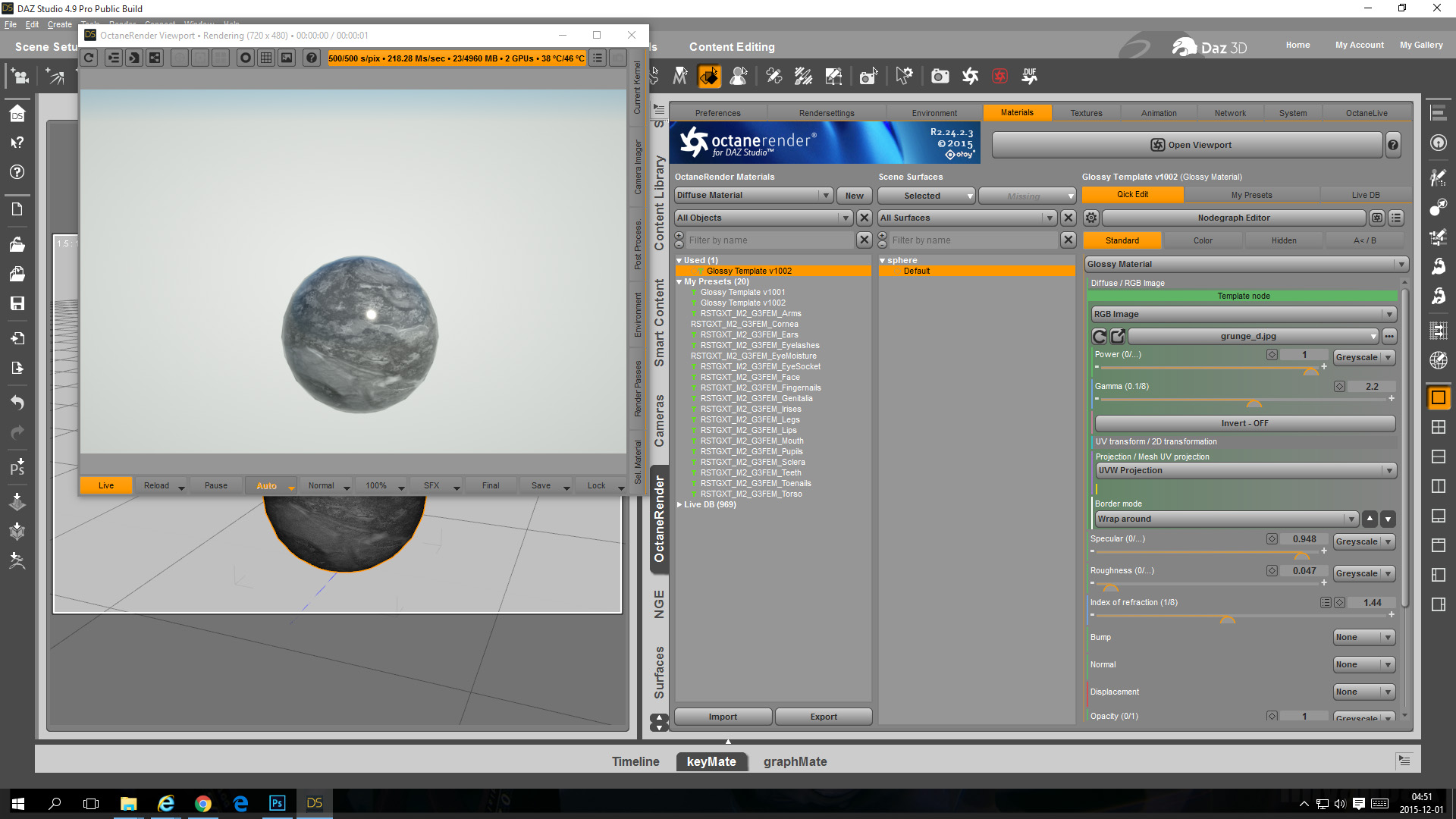

Replace maps - simple template material workflow
The "Replace maps" feature makes it possible to work around the limitations when saving OctaneRender materials with template nodes as DAZ Studio material presets.
- 001 OR material after auto conversion
002 applied DAZ Studio material with template node
003 right click option - Replace all active maps
004 End result - template material combined with map in DAZ Studio surface tab

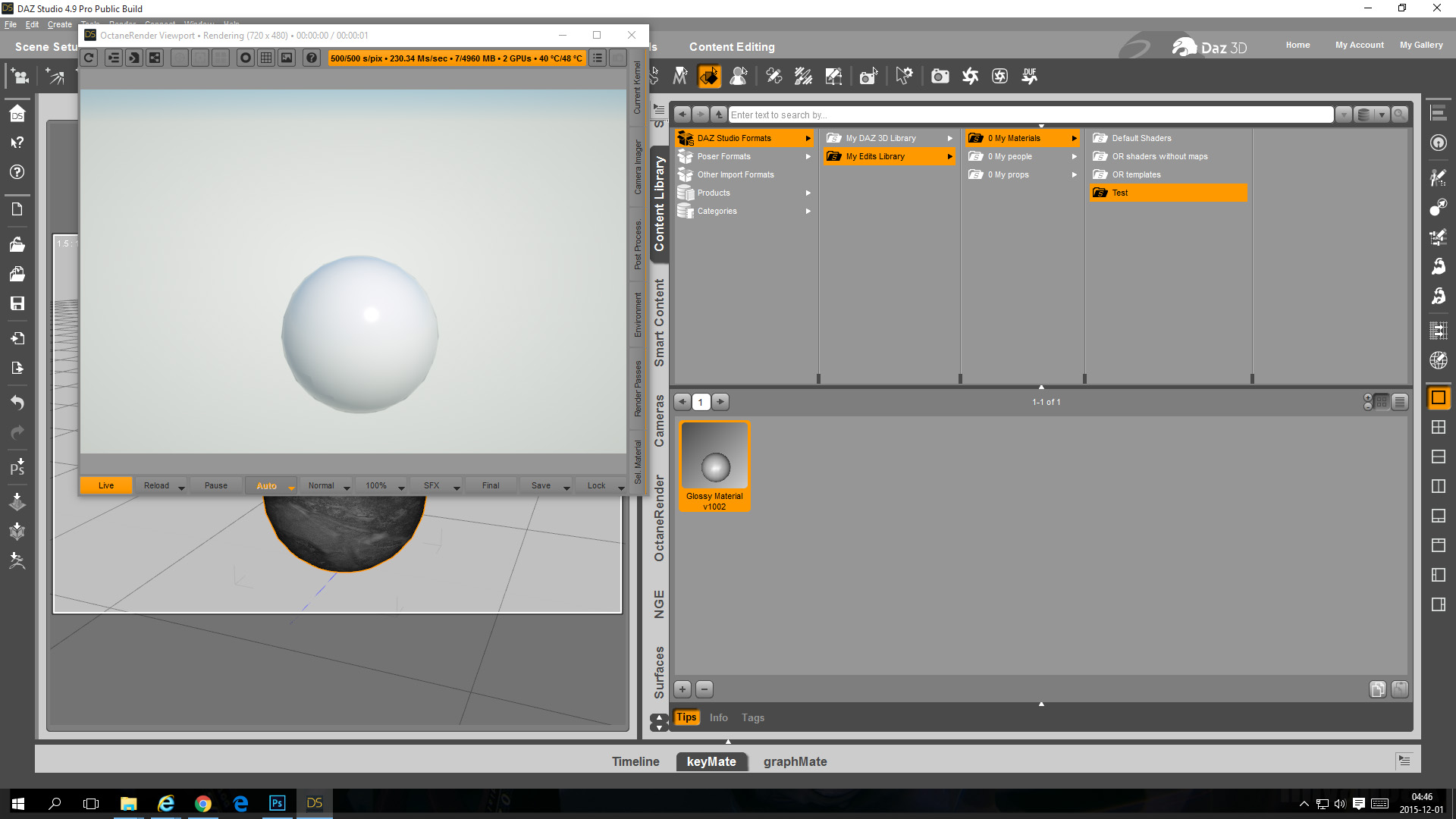

Creating a DAZ Studio material preset with templates on multiple surface zones
Now we can combine once again everything already discussed to create a material preset that includes multiple surfaces and templates.
Instead of dragging over RedSpecTGX user presets from materials to surfaces in the OcDS tab
you can
- click on the saved RedSpecTGX DAZ Studio material preset
- select all surface zones in OcDS
- right click and "Replace all active maps"
The following workflow may take some time to set up the material preset for the first time.
But once that is done it can be used very quickly in the future:
001 apply Genesis 3 Female RedSpecTGX to all surface zones:
002 use the clear texture right click option to remove all applied textures from the template nodes: Step 002 may be optional.
003 save as material preset - make sure to only select the option "tags" on each surface zone
Now create a new scene with any new character
004 apply DAZ Studio material preset 005 DAZ Studio material presets including empty template nodes loaded 006 Use CTRL +A to select all surface zones and right click the selection and choose "Replace all active maps" 007 character specific maps loaded
