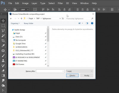

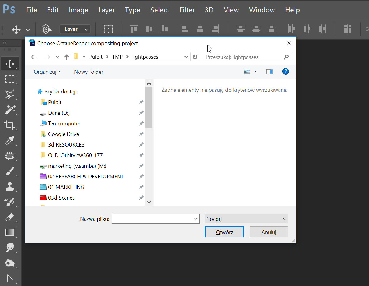

I have installed, but plugin only imports some unknown *.ocprj Octane Compositing File.
Is there any way to open multilayered EXR file within Photoshop?

orbitvudev wrote:I have installed, but plugin only imports some unknown *.ocprj Octane Compositing File.
You can just load EXR as you'd do with any other format. You can find all about the Octane Photoshop extension, including how to export and use compositing files in the docs:
https://docs.otoy.com/#standalone-v3-ap ... otoshop-cc
