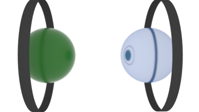

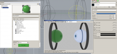

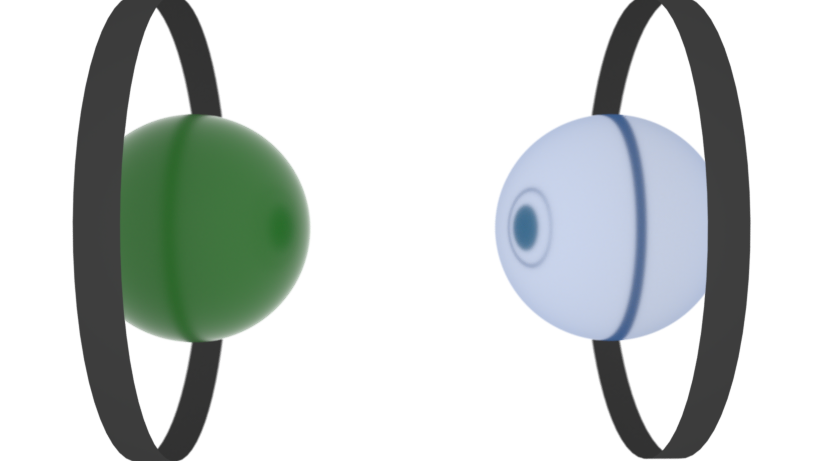

I understand if you don't understand my words, but my screenshot shows that something is wrong. OK, here a new example. I tried to setup the same material - green one is Octane material and blue one is Rhino material. Good to see, at the Rhino material is missing the fresnel effect and the roughness.
If I play with the Rhino material than I get the impression that reflecetivity is connected to the Octane IOR slot, gloss finish is connected to specular and the IOR slot is not connected. Specific rules for connection: please connect the Rhino IOR with Octane IOR, the Rhino gloss finish with the Octane roughness (rule: roughness=1-100/gloss finish) and the reflectivity with specular. Also a Rhino IOR=0 means no reflection, please don't use it for metal.

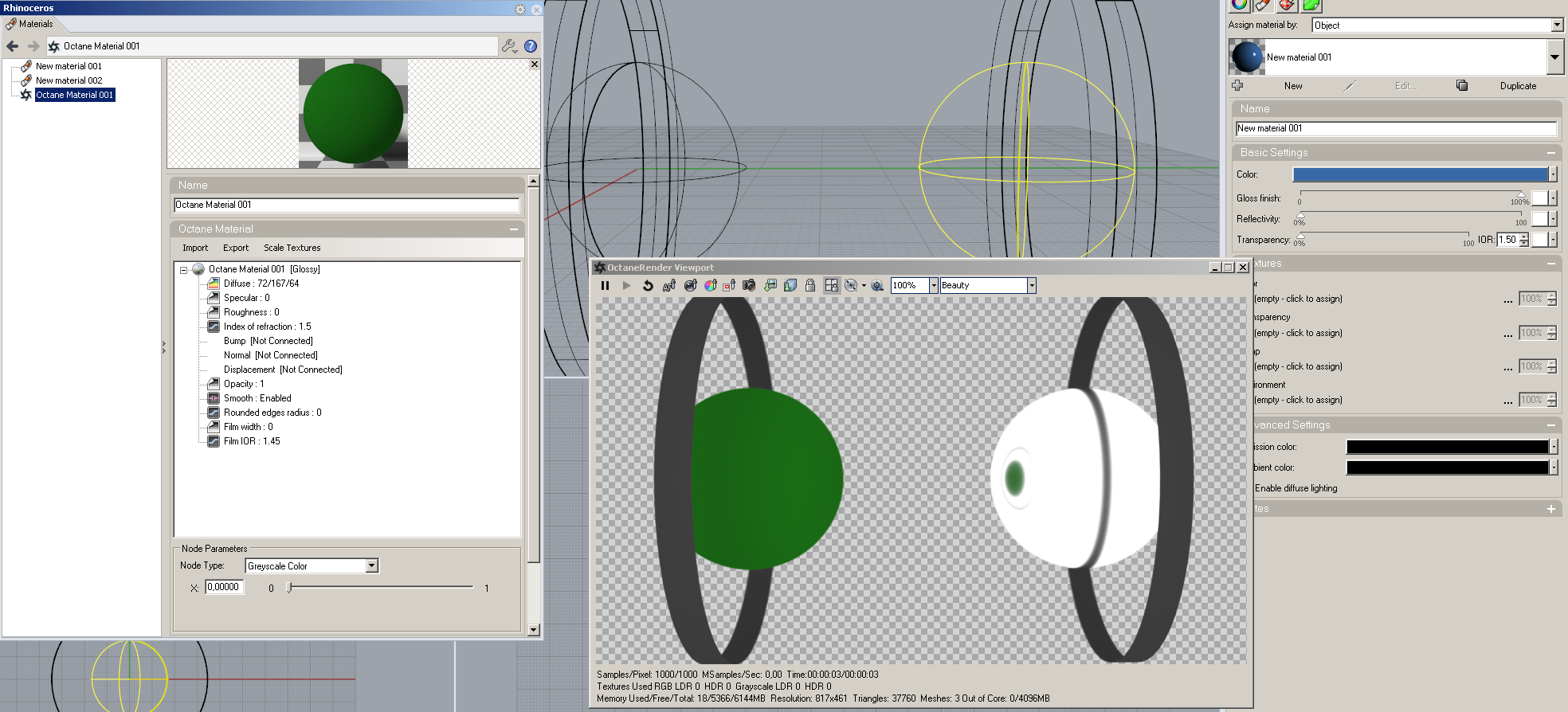

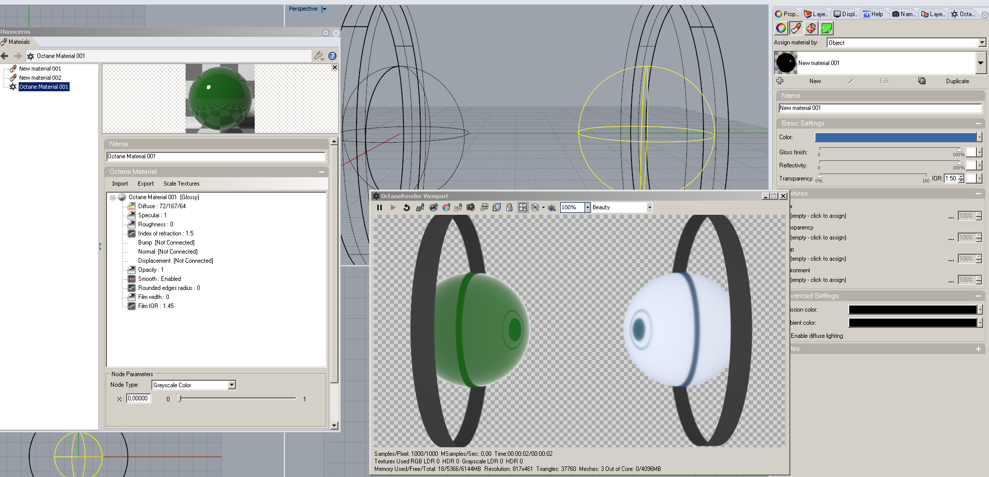

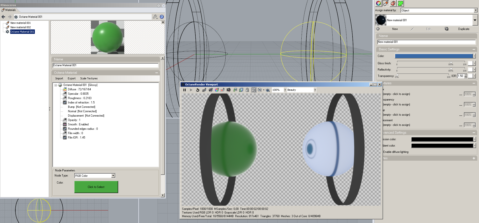

Here some more examples of the current wrong connection
plastic material with full clear reflection
plastic material with specular/reflectivity = 0
Rhino file is attached. Good luck.
