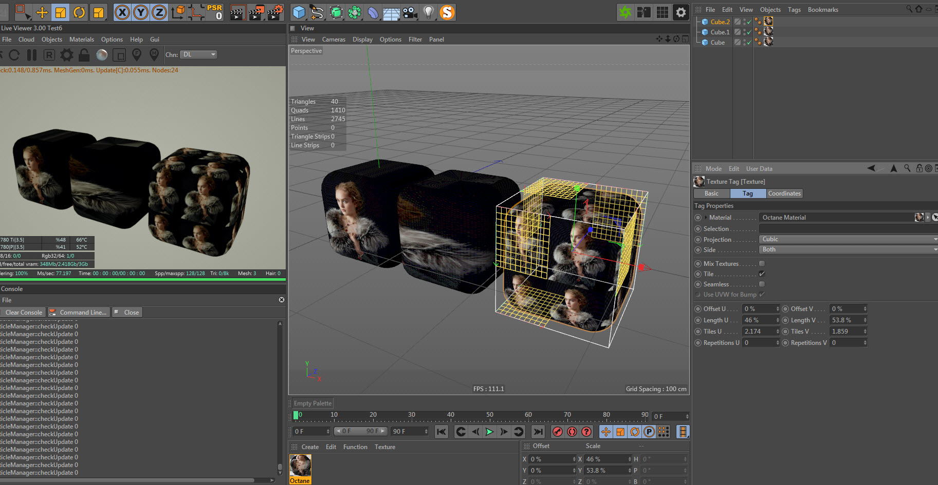

Of course. That's working with all C4D projections as you can see in picture. Can you please post a simple scene to see your settings? I think you're not figuring well the issue.bendingpixels wrote:Thanks for getting back to me.. .LOL user error is way more than most of my problems. I attached the image i've been working on.
The logo on the mug is stuck there using the mix texture, but I got it into position by screwing around with the UV Transform node for a long time until it finally showed up in kinda the right place.
Are you saying that the regular C4D projections should work? I tried that and got no results. Meaning that the image didn't show up on the object unless it was set to UVW.
Alpha

Hey, here's just the mug. There's 2 versions. the one I used in the render with the UVW transform node. and a second that has a mix material applied with no uvw transform and the texture tag set to flat mapping.
thanks again for the help!

Here is corrected version. Flat mapping had wrong scaling.

Hmmmm as I said before operator error is most of my problems. I'm pretty sure that I moved the texture around in size and space, and it nver showed up. BUT regardless I understand what I did wrong, and thank YOU for the help!! I'm really loving Octane so far. I never got anytyhing that looked this good from the C4D render.
