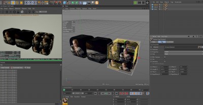

bendingpixels wrote:Thanks for getting back to me.. .LOL user error is way more than most of my problems. I attached the image i've been working on.
The logo on the mug is stuck there using the mix texture, but I got it into position by screwing around with the UV Transform node for a long time until it finally showed up in kinda the right place.
Are you saying that the regular C4D projections should work? I tried that and got no results. Meaning that the image didn't show up on the object unless it was set to UVW.
Of course. That's working with all C4D projections as you can see in picture. Can you please post a simple scene to see your settings? I think you're not figuring well the issue.
2.ZIP
(149.81 KiB) Downloaded 196 times
