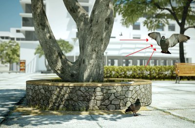

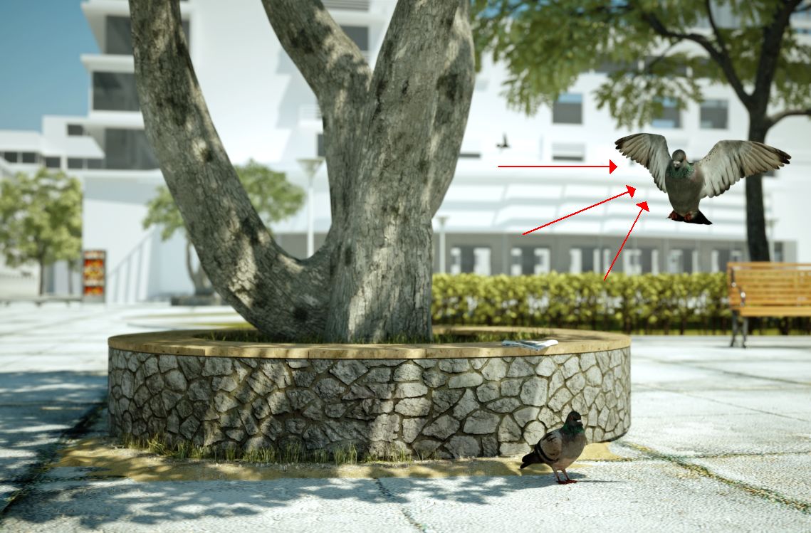

Can you make blur function for the static image without using animation?

Elvissuperstar007 wrote:Can you make blur function for the static image without using animation?
I will have a look at it. I thought, LuxC4D does it already, but I may be wrong here.

Camera motionblur should work with one frame. But all pre23 versions can´t render it.
With beta2.2 it works...

No, I want to blur the statics, no export animation

Elvissuperstar007 wrote: No, I want to blur the statics, no export animation
äh?
Without any animation you can´t have any blur...
For a single frame, also a click on the render button, not the render animation button, it works if your scene have an animation.
But it works not with any pre versions, the last worked version is Octane v1.022_beta2.2.
And it worked only with camera animation.
What you want is object motionblur.
That can only work, if you send min 2 frames to Octane, because you need two positions for every vertex. With this two positions, you can calculate the direction of the motion blur.
