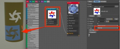

I swapped one of the images used in your sample file (opacity channel) with a coloured logo and my render was showing simply the silhouette of the logo shape stuck on the cylinder, all white, no colour or visual detail. ie it was just a white sticker.
Again: You should do a proper setup for your images. You can't use "alpha mode" in imagetexture if your image hasn't that.LanceClayton wrote:I swapped one of the images used in your sample file (opacity channel) with a coloured logo and my render was showing simply the silhouette of the logo shape stuck on the cylinder, all white, no colour or visual detail. ie it was just a white sticker.

Thanks Aoktar, I'm really trying to follow but I'm missing something. Please see my variation of your 'Stacking' file, there must be something that I'm not understanding.
My image has an alpha channel and is loaded into the opacity channel exactly where yours was.
We'll get there!
We'll get there!

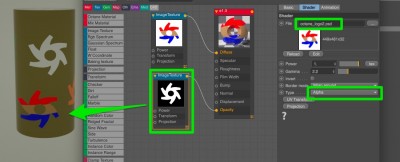

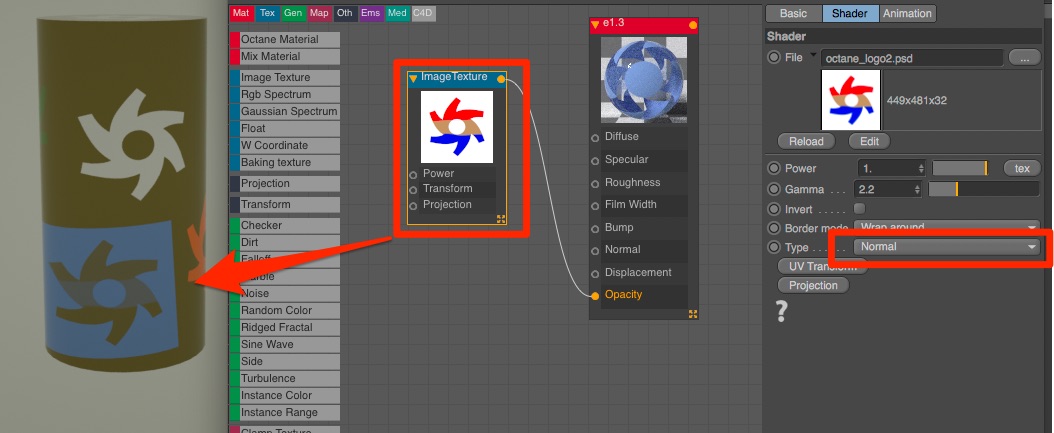

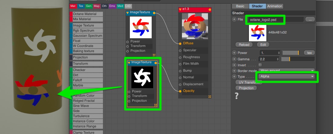

Hi Lance,
Your image does have an alpha, but you haven't told octane to use it.
you're type is currently set to normal: change it to alpha, and you'll get what you expect: If you want the same image in your diffuse, just duplicate the image texture node and plug it into diffuse (with the type reset to normal).

Finally got it!
Thank you all for helping out.
