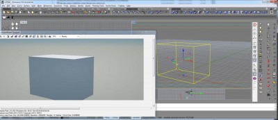

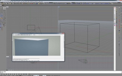

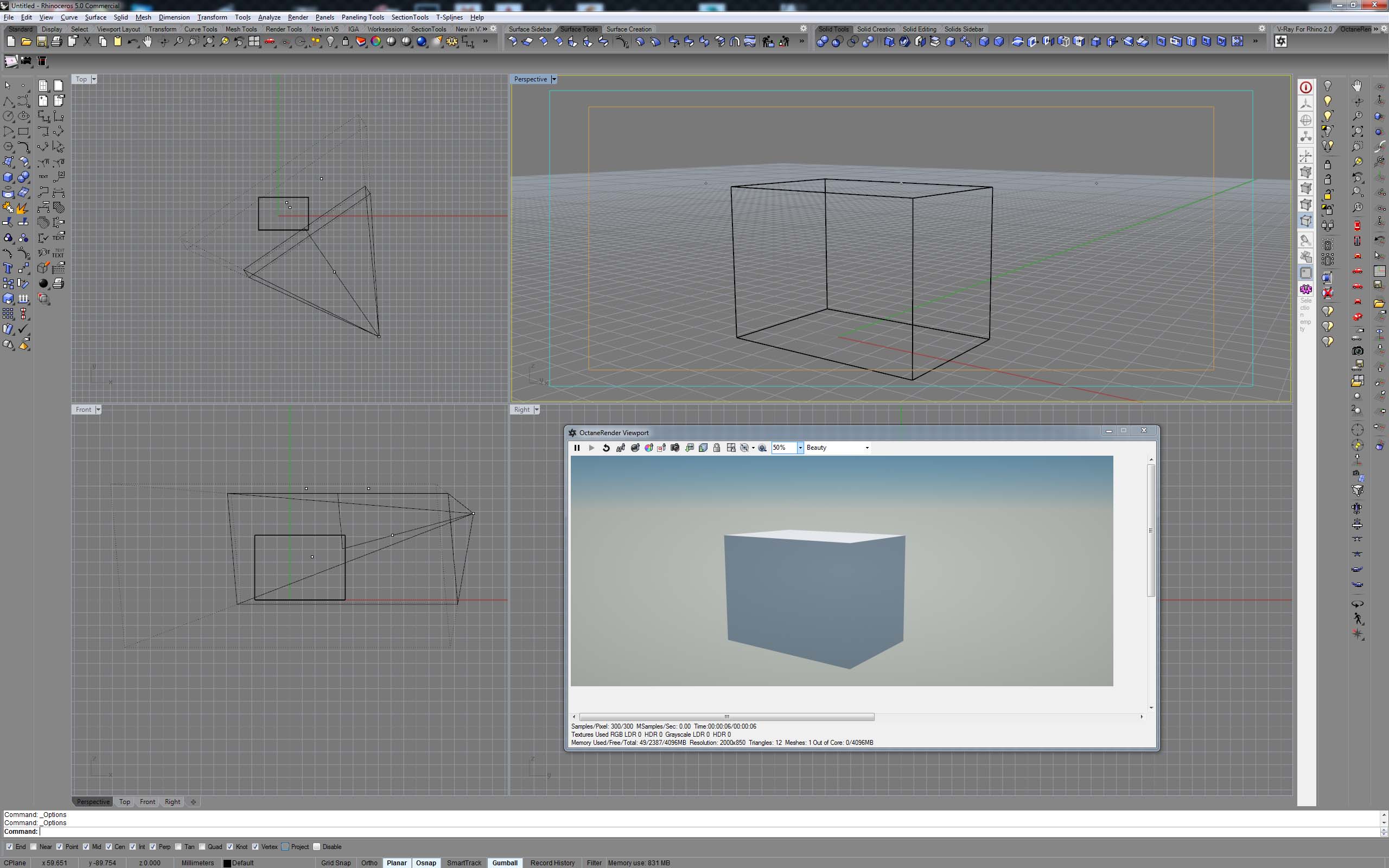

Hi Paul.
Hopefully this explains it better, see grabs below.
The render output changes if the rhino viewport is changed even if the FOV isn't changed. So for example if I don't have Rhino maximised to my screen and the viewport aspect ratio changes the render output changes.
You can see that the position of the box in the viewport in each of the screen grabs is in the same position to the safe frame but the render output is fastly different.
Does this make sense?
