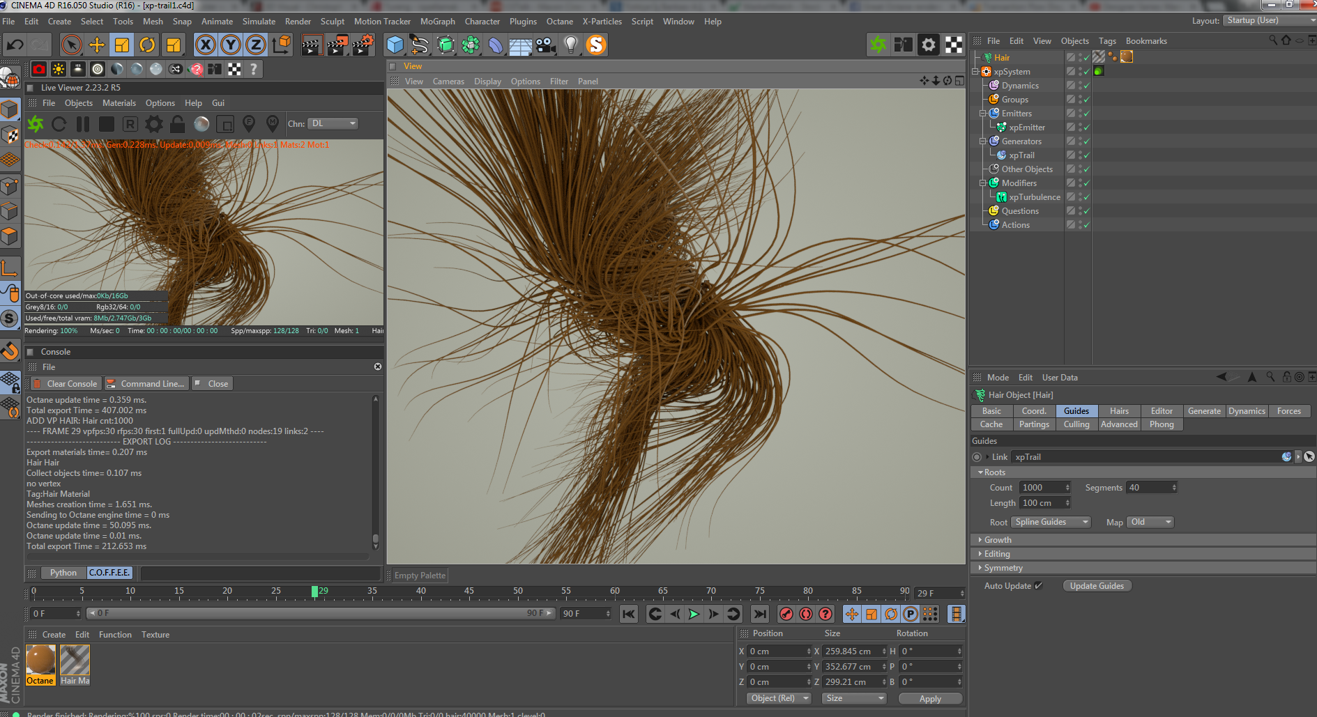

Well this is becoming increasingly frustrating. I had everything working fine, everything was rendering. Then I changed my particle setup (just modifying the same thing that had worked just yesterday) and now it won't render in the Picture Viewer at all.
Ironically, it works if I enable "Spline" in the Hair Render "Objects" tab, but that also provides the same problem I had to solve before- wildly innacurate render results. I'm uploading 2 projects- 1 from yesterday that works just fine, and one from today that doesn't work.
If someone could please help me that would be wonderful, I feel like I'm going insane over here!

i'm checking it. It should work as how hairs do in theory. But my first idea is that there is a problem with caching of XP+trails. When i scrub the timeline it behaves little strange. I'll post my decision after doing more tests.

You forget to enable Hair Render->Objects->Spline. Also your scene looks behaves strange on output. I can't understand why, but please use my scene. It's working well on LV or PV.

Ya like I said above, when I enable "Spline" it destroys the output. I have other scenes almost identical to this one that work and render fine without it enabled. For some reason this one is just... broken. Well thanks for taking a look maybe I'll just use Physical Render for this shot

I actually figured out a solution for this... If I disable the "Spline" setting in the Hair Render options, and then in the Hair Object set "Cloning " to 1, zero out the root and tip settings, it renders as it should. And just so you know this is not an Octane issue, I got the same behavior in the other renderers when I tried it. Must be an X-Particle/Hair thing. Anyway thanks for taking a look :)

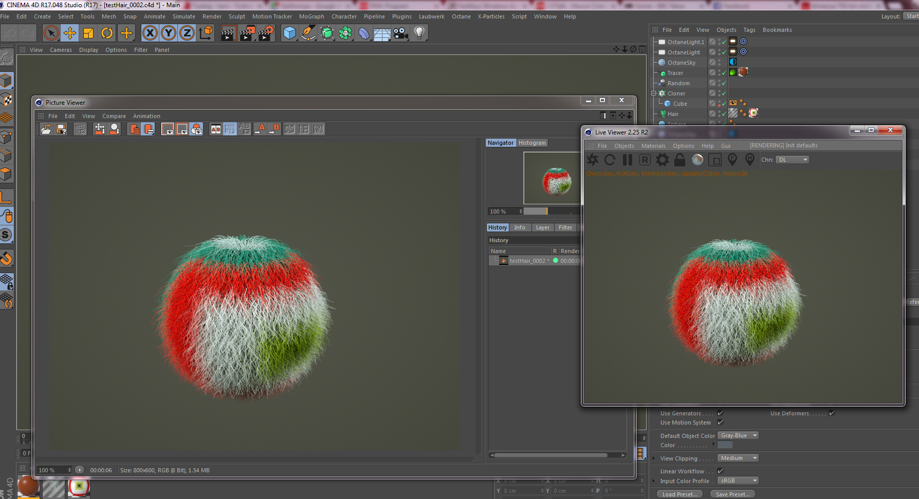

Is this addressed only in Octane 3.0 alpha? Because in 2.25 R2, I am getting the same problem using hair with the PV not rendering what I see in the LV. I opened the scene that you posted in this thread that shows your pic with the LV and PV looking the same as it should. But when I render it your scene, the hair does not render in the PV. This is a constant problem that I've been seeing with Octane c4d... the PV not matching the LV.
What can I do in 2.25 R2 to make your hair scene work?
-Alex
That's working. Can you show me a scene which is not working?
Your file...
My file...
Neither seem to work. Can you send me your most recent example? Thank you.
Here are the two scene files I used...
SceneFiles.zip
(3.19 MiB) Downloaded 217 times
