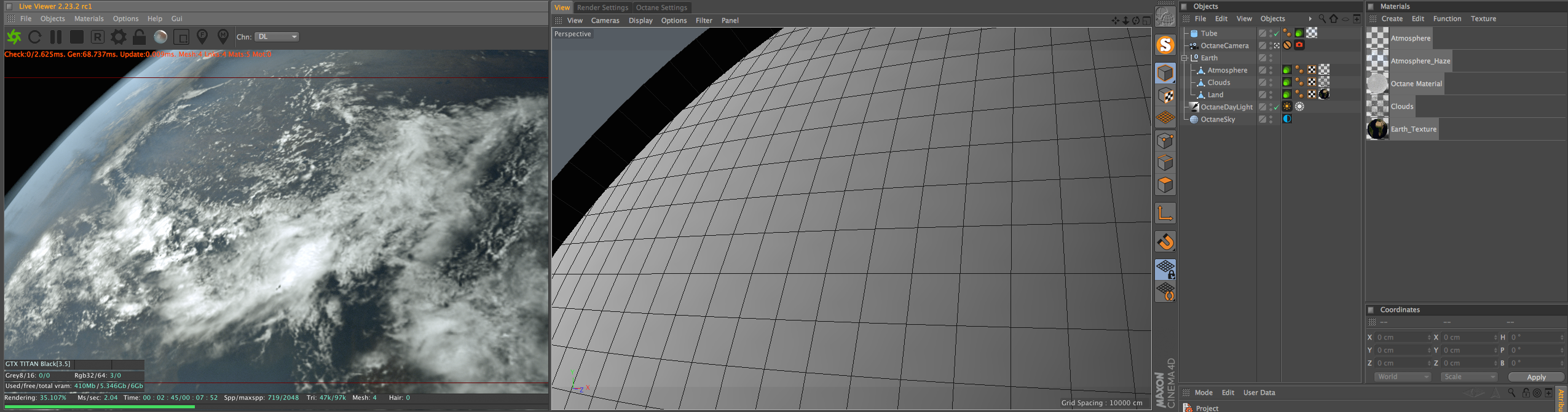

Ok, I may have figured it out, or gotten close enough for what I need. I realized the scattering has fall-off, but only if you look through the solid that its applied to. From a direct angle, you'll see a hard line (like i've been getting). So I made a tube primitive that acted like a halo around the planet from my camera's perspective. This created the solid volume needed for the haze. The other haze atmosphere I left on, because it was adding some nice gamma to the land masses. All in all, I'm fairly happy with it. I could refine it more, but I'll just leave the project files here for anyone who feels like trying to make it look better.

Could upload this to dropbox project? Will be useful for others.

Ohh that's exactly what I need right now - been struggling with this for a while, so thank You for sharing :D
